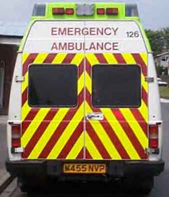

  • Lorraine Buchan
    22 April 2004 at 04:11
    these are cheverons
