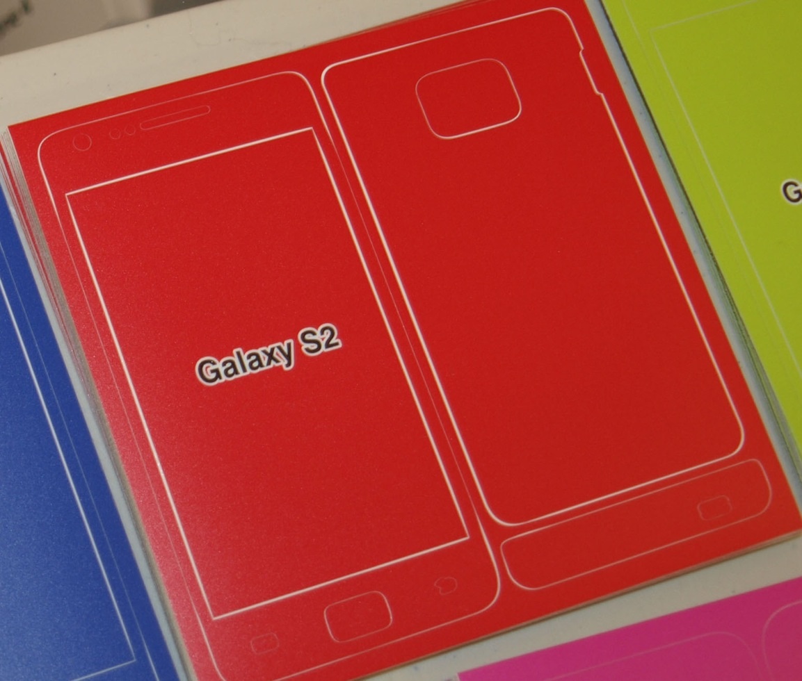

Posted by jacobhinson on 21 October 2012 at 10:19Hey guys,
I’m pretty new and have a constant problem and need to know how to fix it!!
We sell skins for phones and have been using a supplier to print them for us, we are
Now bringing Everything in House but keep on getting the same problem with our supplier,The skins after a few weeks or so keep on shrinking, To the point where they will not fit on mobile phones! On a piece of vinyl that is 15 cm x 15 cm the cuts can shrink up to as much as 5mm
Has anyone had this problem before or can anyone offer some advice to stop this from happening?!
We use 3M ij40-c Which is a pretty expensive vinyl and you do not expect this to happen with it!
PLEASE HELP!!

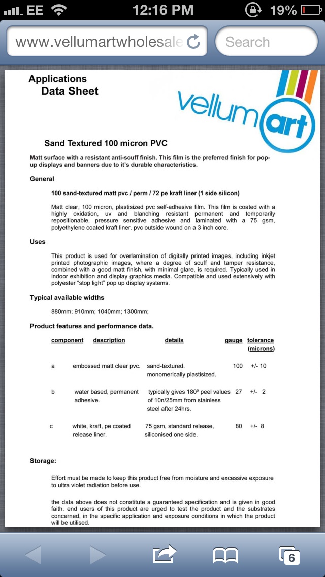

I suspect the clear laminate you are currently using is the cause of the shrinkage. This is a monomeric vinyl which is prone to shrinkage. I would try a different laminate of similar spec to your print vinyl (i.e 5 year polymeric calendered vinyl).

I’m currently buying off a local guy, do you know where I can pick up sandtex that is the correct grade?

The only thing is, this was on a satin but we prefer a sand tex…. Do you get plymeric sandtex?
http://www.cphgraphicsupplies.com.au/pd … _52_57.pdf
pro santex laminate can’t vouch for it but but it is polymeric not monomeric
ask them for workable samples
oh and the pro has a solvent adhesive not water based if that could be part of the problem
