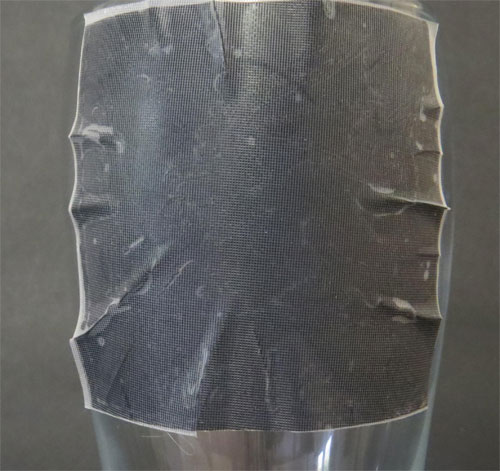

    New to all this. How can I prevent this happening when wrapping curved objects such as this glass?

    Use the correct material. Use a bigger piece of material. Use heat

    You are trying to wrap using application tape. Application tape does not stretch.
    Not that any should be used in this instance, but the application tape that you have used is the worst of the two types of app tape available. this is because its a plastic ribbed tape and will crease easier on the rib pattern and will also have a stiffer feel too it, making any sort of conforming more difficult.
    You cannot wrap the exact size of vinyl onto a convex shape. it will distort and may crease when conforming.
    You need a larger piece of vinyl to apply, then trim to size once in place.
    You need a decent Calender or use Cast vinyl to prevent shrinkage, curl-back of the media if over stretched in any area.
    clean surface using Isopropyl alcohol or meths.
    Once in place, Apply heat and rub firm with a felt squeegee around the edge to prevent pull-back.
    I wouldn’t Post heat to 100 degrees as are your likely to crack the glass. to be honest it wont need it if applied correct. i.e. little or zero stretch.
    using a bubble free / air escape type media will "help you" too.
    practice makes perfect and to be brutally honest, this should be applied in about 1 minute, trimmed and onto the next.

    1. Get a piece of 3M 1080 or equivalent twice the size in both directions
    Don’t use app tape
    2 Heat it up and pre stretch it to 20% bigger in the up – down direction. Stick one edge to a car door frame or something to accomplish this
    3. With heat it will shrink itself into the curve of the glass without wrinkles if you control it right.
    4. Cut it to size with a stainless steel blade which wont mark the glass

    I will be doing a quick Blog on pre-stretching wrapping film, so wont go into it all just now. but i do not believe pre-stretching to be the best method for convex curved applications.
    I have asked various people in the industry with many years wrapping experience that actually use it and i have yet to be given a credible answer to my questions. "I have no doubt reverse shrinking works", as they are simply relaxing the media when hitting it with heat. but it is fraught with danger and there is a simpler and safer way to achieve same. there are also an array of vinyl’s and instances where it could/should not be used.
    as for the glass, there really shouldn’t be much if any stretch needed here, just an over sized bit of vinyl worked with the heat of your finger/thumb into shape. followed by some heat to promote adhesion.
