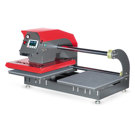

    Also saw this on one and wondered why they have some black material wrapped around too platen?

    can’t help with the material side of things but press the black thing looks to be a teflon sheet held on to the heat platen which is easier that putting a loose sheet in each. If you are looking at doing high quantity then maybe an air press twin bed would be better suited. with the twin bed you set 1 shirt whilst pressing the other not cheap but pressing a 1000 shirts is a lot of work

    The red heat press which is shown in the pic is a secabo. I also have this and 4 years of heavy work and its not had any issues, one thing i like about it is the automatic opening, so once your times done it opens.
