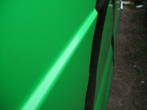

    Today I used this vinyl (Hexis Hex’press series HX10000) on my van and must say I am actually very impresses with it. It went on so easily with little effort, had no problems except one small area where I over stretched it and it lost a little bit of colour. It makes wrapping as an amateur so easy.
    I reheated the recesses but was not able to check temperature as I don’t have a temp gun so now will see if I have any problems in the future (also fitted outside) . It is only on a Transit van so not really deep recesses but will keep you updated to any problems that might arise.

    I can make a quick update on my experience with the Hexpress vinyl. The last update was just after fitting and it was nice to work with but has since pulled away from the recesses very slightly (see picture attached) I do think though this is due to my application as it was done outside and even though I reheated it again I don’t know if it was hot enough.
    The second (worse) problem I found is on the flat areas, it’s hard to explain the effect but if you can imagine scraping down a painted wall but not scraping all the paint off and not smoothing it down before painting a new coat of paint over it, there is a mottled type effect from the glue I presume that gives it this appearance, it is only visible from certain angles in the light but does not look right, generally a person looking at it would not even notice it but it’s there.
    I have not complained to Hexis as it was not fitted in accordance to their spec sheets so have no argument although I’m generally happy with how it turned out, might try it again one day to see if it is me or the vinyl.
    cheers

    Most of the bubble free vinyls have a slightly mottled effect. That is the air release channels.
    it’s not that mate, it’s random and in large patches, not an overall texture. It looks as though some of the "channels" have all been flattened in some areas and not others, like a camouflage effect with many large patches 😕 if you know what I mean 😉

    it’s not that mate, it’s random and in large patches, not an overall texture. It looks as though some of the “channels” have all been flattened in some areas and not others, like a camouflage effect with many large patches 😕 if you know what I mean 😉
    I know exactly what you mean Warren, I’ve just fitted this vinyl to the back doors on my own van and had the same happen to me!!! 😕
    I still have to do the sides so I’ll see what happens and keep you posted.

    Yes mate, squeegeed really hard to see if it made a difference, tried different pressures on different areas but the same happens, even tried heat and squeegee to see if that made a difference but NO 😕
    I think I might speak to them as it was nice material to work with so would be a shame not to be able to use it.

    OK I just got off the phone with Hexis and they call the problem "bushing" they are aware of it and did say that many people have commented on it and they have now just introduced a 2nd generation material that will not leave this "bushing" effect. They say it is because it has to be applied exactly as per the instructions which is different to how you would apply normal wrap vinyl 😕 However the 2ng generation material will be applied as normal wrap vinyl and that problem will disappear. They will also be doing a window etch and maybe even window coloured films (transluscent I presume)
    So the official word is YES there is a "problem" but is not bad enough to warrant replacement (so it seems) as it is not that visible and customers should be happy with it.
    The new 2nd generation material will be the next best thing to sliced bread apparently :lol1:

    Peter I’m not 100% sure, I’m just quoting what the tech guy at Hexis told me. I did get a 2 page instruction sheet with it and he did mention something about preheating the vinyl to 100 degree first. I think they must have realised the problems too late and now have a creative answer along with the 2nd generation material coming to hoard off any unwanted conflicts, JMO.
    I do believe though that due to the pattern on the adhesive it can leave a pattern on the finished product on some bubble free wraps but that is a uniform consistent pattern as the glue is uniform and consistent across the vinyl.
