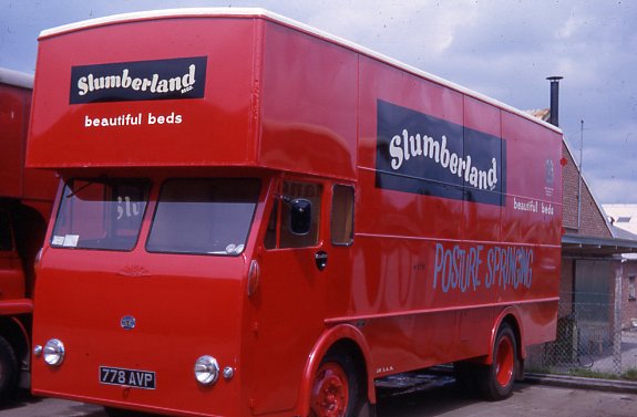

    The red Slumberland Albion claymore truck vintage 1961
    sign written by my good self over 40 years ago. Materials use for this job
    were John T. Keeps Ltd synthetic writing enamels & Keeps coach paint.
    3m scothlite was used on the front & rear Slumberland logo, it was cut by laying cut Perspex letters on the face then cut round with a scalpel knife, long before cutting machines

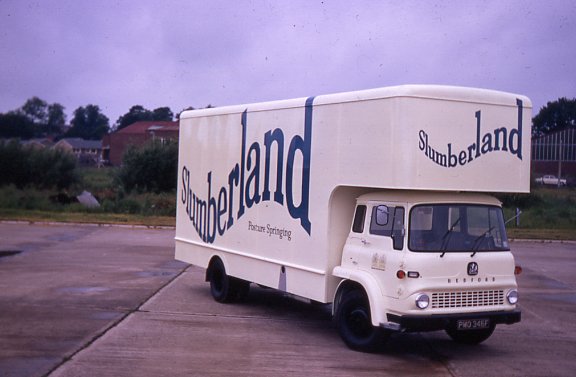

    The white delivery van Bedford TK again written in the late 60’s when
    the image was change to the new company logo still used today

    chris …that looks great . Question did you pounce the slumberland onto the other side or draw it out ?
  • Christopher Bevan
    8 September 2006 at 15:38
    quote :
    brian little wrote:
    chris …that looks great . Question the white bedford did you pounce the slumberland onto the other side or draw it out ?
    We did approx 30 of these Bedford TK’s at that time, every van was a different colour (it was 60’s flower power time)
    We used an episcope to train the image full size onto 3’ wide brown packaging paper then
    traced the image with an artists sketch pencil to produce the whole side drawing, then of course turned
    it into a pounce, cutting the whole drawing the into sections for handling. The one template did every van . The sections were reassembled on van sides, pounced with charcoal pounce dust, on removing the paper pounce there was the image ready to write, using a large flopper writer & 2” Hamilton paint brush and with a little etch solvent added to the paint you were applying, it was well & truly bonded to the van body sides It had to stand up to the very vigorous automatic wash brushes
    on average to hand paint one of these trucks took about 14 hours & there was not any brush marks on the letters All this work for £75 a truck plus materials

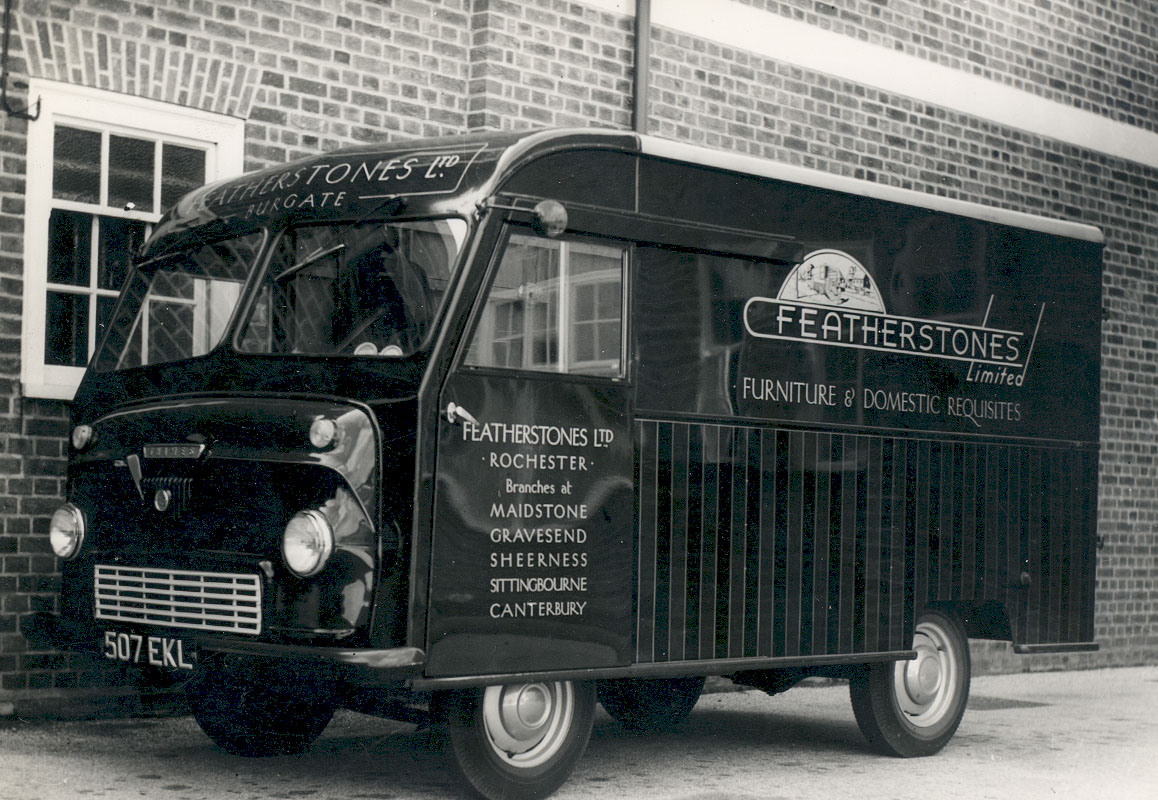

    Whilst i have done very little hand painted work, my Dad spent many years graining marbling and signwriting here is a photo of a couple of his jobs

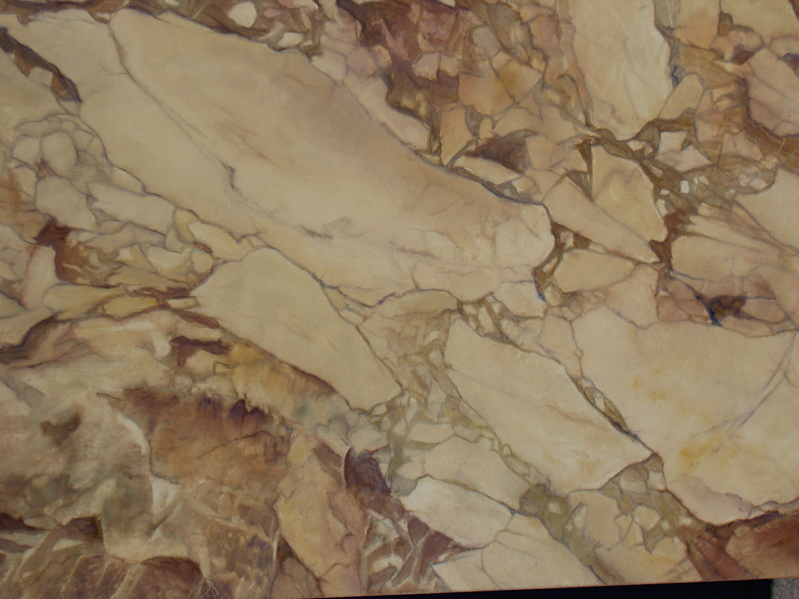

    Thanks, he gave it up to turn professional as an artist which was his true passion, but since retiring he has started to do a bit of graining and marbling for recreation again, here is a small marble panel he did a year or so back

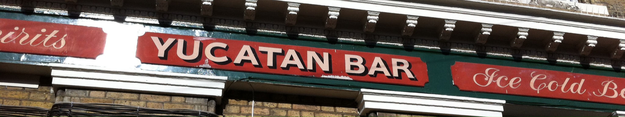

    Yucatan Bar
    This pub has been painted about 5 or 6 times since I did the signwriting. They left the signwriting alone. My signwriting is still there after nearly 24 yr
    Everything freehand – no paper templates – just get up there with a piece of chalk to mark out and then paint in
