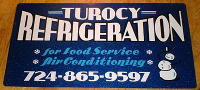

    All hand painted wow they look great!!! You do terrififc work Jill.

    did you have to paint the backing colour or is a colour metal that is used?
    ok probably a daft question but…
    when painting a sign like this by hand, do you have to wait until the white is dry before painting the outline? i know the obvious and safest way would be to wait but thought this may take ages…
    the reason i ask is i always see the hand written signs with the painters shadow… the little space between the shadow and the text. i am led to believe this came about to save time when painting work as you could hit it with both colours withought the paint mixing, due to the space?
    or am i talking crap and i should keep to the sticky stuff? 😳 :lol1:
    30 September 2004 at 18:24
    Nope, Rob, for a licky-sticky guy you are correct in your assumptions.
    I am no authority, but I believe that the drop shadow was invented by
    a signwriter who was in a hurry.
    Lettering enamel takes ages to dry, and rather than waiting,
    all you have to do is use a mahl stick to rest your hand upon,
    so you are not continually dragging it thru your wet paint.
    I did the white lettering two days ago and let it dry overnight.
    Then I did the outlines and secondary copy yesterday.
    Then I had to do a quick double-coat on the white! GRRR.
    The material comes from Laminators Inc., a PA company.
    It is made in various shades like candy apple red and safety yellow, etc.
    You can also purchase edge caps from them, which I did,
    and you trim them with a Stanley knife and apply using silicone.
    Love….Jill 😉

    Jill has the reduction of your photo for the web caused the apparent distortion of the word ‘Refrigeration’?
    I’m looking at the tops of the letters where they conform to the curve. The cross bars of the letters seem to
    have lost their uniform thickness and appear to taper.
    Other than that I think you’ve done great in achieving the clients requirements.
    Cheers, Pete
    1 October 2004 at 12:01
    Nope, I tapered em by hand….
    of course, following my pounce pattern which
    I made on the computer!
    I sorta liked em like that….but then again
    I am getting senile.

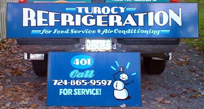

    Here’s a closeup. It’s the matching long sign.
    Love…..Jill 😉
    8 October 2004 at 15:27
    And here for all you stickerheads….
    an all-vynull version!
    Covered regular magnetic sheeting with
    sparkley stuff & stuck away.
