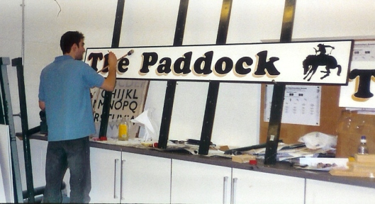

Posted by evo1v on 22 May 2004 at 03:16Well its my best side!!

nice one mate, did you paint that yourself then? looks great!
by the way, do we always get a side shot of you? 😆 😆
thanks for taking the time tyo load mate
This was one of my first, the letters where traced on, so part of it was made easy!, I dont have the steadyest of hands so for me its a major acheivement!!!
A painter!
What a sight for sore eyes!
The sign looks good too! hahaha

Great work Lawrence! 😀 You weren’t codding when you said you done a little painting, thats huge! Traced letters or not, to get that quality of finish can’t be easy. Did you paint the horse as well?
Cheers, Dewi

This was all painted in gloss, none of that proffessional stuff here 😀 , the horse was painted also, and was probably the easiest part, being that the edges are more random so any small mistakes arnt noticed!
I think the hardest thing to get to grips with is the 90 degree corners you would get on most lettering, if you look at this one you’ll see there arnt any, probably a better font being a begginer 😀Lawrence
