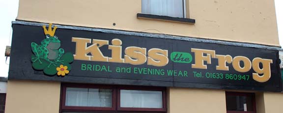

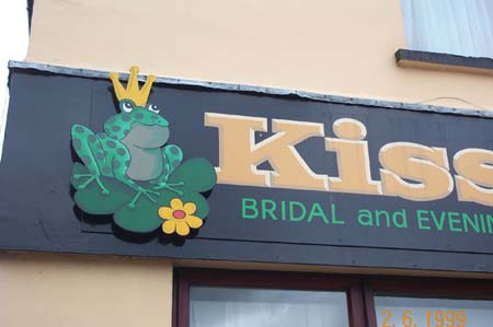

    Here’s one I did for a ladies wedding/evening wear shop.
    All hand painted and the frog is plywood cutout, hand painted then fixed with 2" timber behind to stand off the main sign.
    Neil 😀

    29 November 2005 at 20:11
    Looks the biz Neil,
    How do you set up for something like that? Is it freehand, or do you use a mask of some sort? Also if a may ask, did you paint it before mounting? I guess you did because of the panel,
    But just wondering what is the norm for something like this.
  • Neil Davey
    29 November 2005 at 20:22
    Thanks Peter,
    Yes it’s all freehand, mostly, I mark top and bottom lines and rough out the lettering in stabilo pencil then hit it with a No. 8 chisel brush. The strap line is done using a little cheat, I ran fine line tape first top and bottom so i didn’t have to cut in those edges, just go over the tape and pull it off to reveal crisp edges.
    Painted in my workshop then fixed to existing fascia and with the weather being what it was I was happy to be inside.

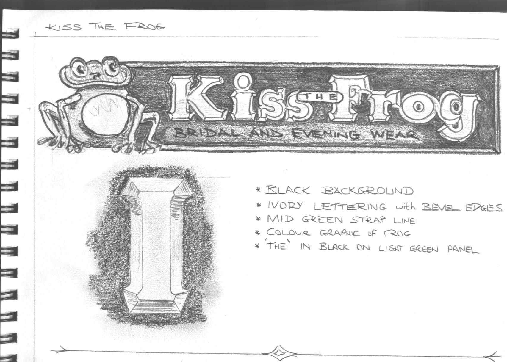

    This is my original pencil sketch to sell the sign to the customer. The finished sign was a little different.
    Neil 😀
