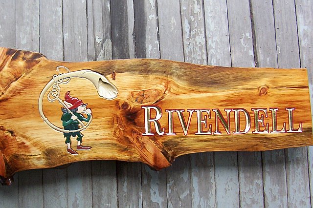

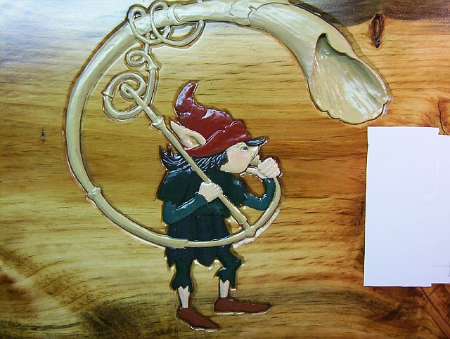

    Two pics here…..The slab is pine. The elf design was supplied by the customer.
    This type of carving is called "incised". It’s a relief technique…..similar to embossed greeting cards. The image is outlined with a deep "V" cut and then the image is carved…..it’s very shallow (except for the end of the horn). This is a good style for beginners to start with.
    Hope you like em… 🙂

    okay well that is just amazing!
    how in the world did you carve that elf, and to get the horn to look that way – WOW
    I mean it’s even got an opening on top

    Is it Oregon Pine you are working with, and what paint / varnish have you used to finish off with?
  • Joe Cieslowski
    24 May 2006 at 00:14
    Thank you for the compliments everyone!!
    Paul, this pine is Eastern White Pine (Pinus Strobus). It grows abundantly in the North East US and into Canada. I’m not familiar with Oregon pine but I think it may be what we call Sugar Pine. I like the working properties of Eastern Pine and the grain pattern is prettier than sugar pine.
    Production: After the slab is sanded, I carved the elf. I then coated out the front and back with 5 (brushed) coats of Helmsmans Spar Urethane (a Minwax product). The elf is then painted with 1Shot (I always add hardner). I apply a paint mask where the lettering goes and then carve the letters through it….prime (2 coats), two coats Speed Dry UV Clear (1Shot), size and gild. Remove the mask and outline the letters. It’s a pretty straight foward process.
    Any clear on wood has a 2-5 year working life. If the owner recoats regularly, the sign will last pretty much forever. I have one customer (that I know of) who says his is as good as new after 20 years…..not bad.
