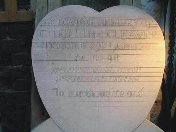

    First, the marking on stage, just a propelling pencil, plenty of .5mm leads, a steady hand and top and bottom lines…ohhh and a dictionary.

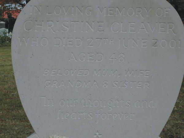

    Secondly, the finished job, Portland stone, fine rubbed, hand-carved 60 degree V cut letters, Self styled roman and cursive lower case.
    Stone was about 4′ high x 26" wide..and very heavy… 😮 😮 😮

    About a weeks work from start to finish!
