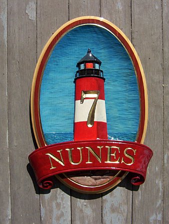

    We call these "House Markers" or "Cottage Signs". This one is 18"x13"x2".
    All pine. The colors are 1Shot thinned to a consistency of a stain (this allows the grain of the wood to be visable), and cleared with 4 coats of spar urethane and 23k gold leaf. I curled the ribbon ends in to preserve a strong feel of the oval. (The ribbon is a separate piece and attached.) Hope you like it.

    beautiful Joe… top notch work as always. 😀

    Joe that’s lovely

    You are a talented man Joe. Thanks for sharing..

    Lovely work as always Joe. Its beautiful.
