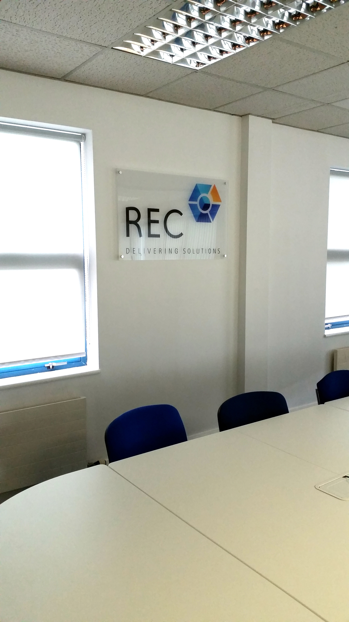

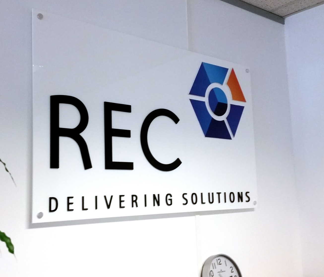

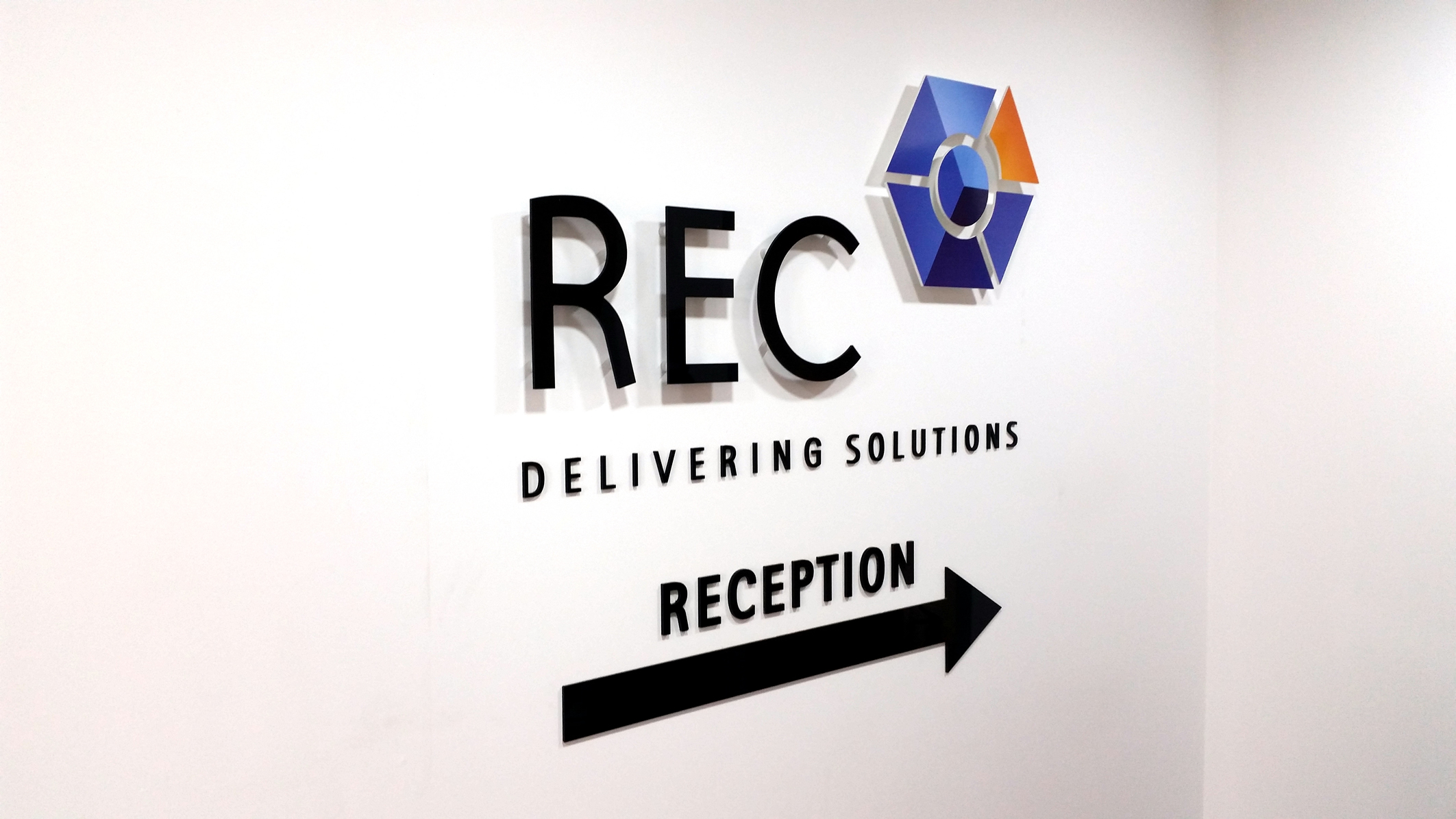

    REC – Part of a larger contract we’ve won rebranding their parent company, and their sister companies offices across the UK, along with their vehicles. Creating something a little bit different, by using 5mm cut acrylic with stand of locators or tape directly to the wall, or bonded to the white acrylic sheet because of the beading between the wall panels.
    It created a great 3d effect, and looks much more elegant than cut vinyl. We also produced a clear acrylic panel, printed in reverse and backed with etch.

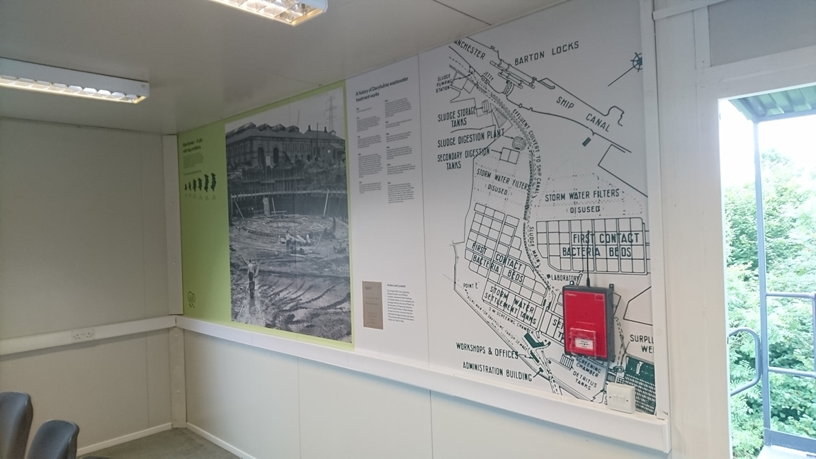

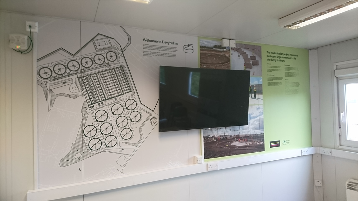

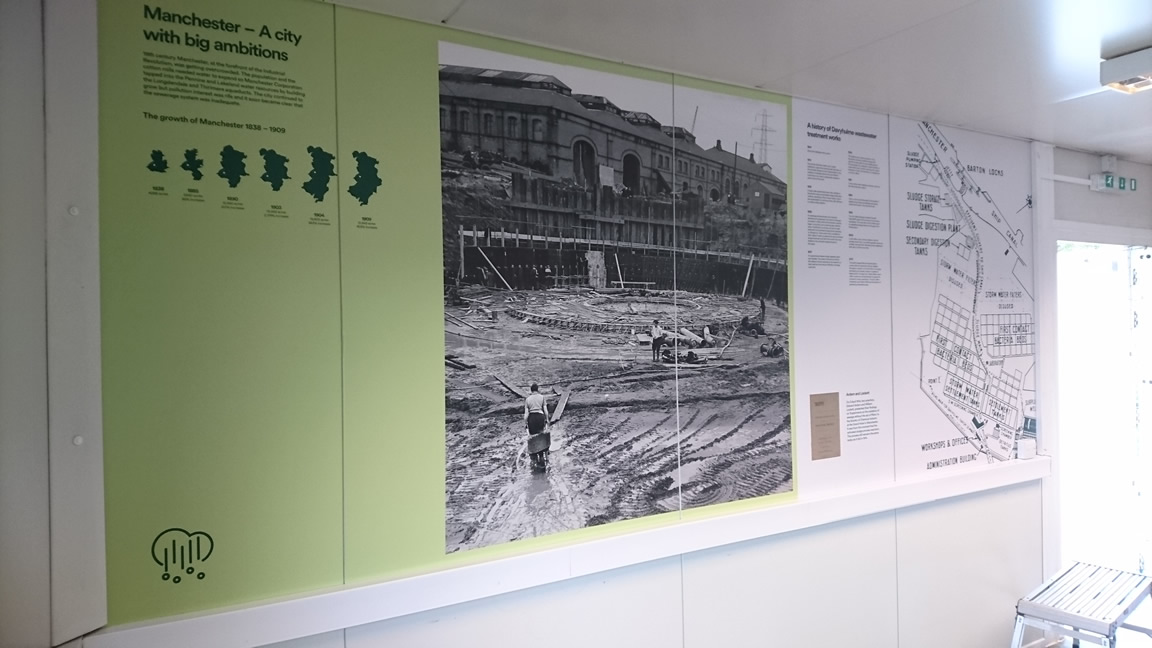

    We were asked by a trade customer to print their design, and install it in a training room at a large contraction project for the local water board, unfortunately we don’t hold CSCS cards, so we outsourced the installation to two lads who are excellent at what they do.
    All printed on Metamarks high tack vinyl, with a matt laminate, we ordered the vinyl on the Wednesday, printed Thursday, laminated Friday, fitters collected Saturday, and installed Monday all in time for the clients meeting.
    Everyone’s really impressed with the finished job.

    The REC sign backed with the etched looks great David, I have some jobs coming up I’m going to try this out on. Well done mate.

    Good work as always David,
    Really like the etch idea.

    Some nice work yet again David, well done mate…
    Can i be picky? :awkward:
    My pet hate is big arrows like that with the long tail.
    I find using arrow heads or creative type arrows much more appealing. i mean this purely as constructive criticism of course. and yes, easy for me to be picky when its not me that did the job. just tell me to shut up and ill go away! 😆
    thanks for sharing!
    17 January 2017 at 08:25
    I don’t like it either 😆 the customer insisted on it. If it were me, I’d have put the reception on the arrow to keep a 3d effect, and bit more elaborate than a big ugly arrow on the wall.
