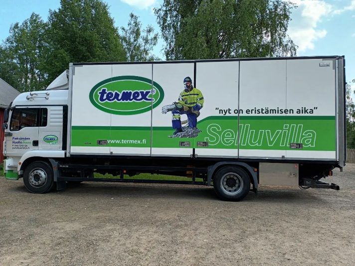

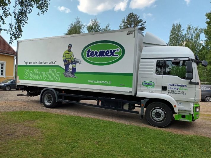

    I fitted graphics to a truck on Friday, the graphics were supplied to me by the client and printed using Orajet rapid air – no other details on the backing paper but I would assume it’s just polymeric.
    This is not a brand I use and I don’t use a grey back or air release. Anyway, i understand that with these you must apply dry, the graphics were very large which i fitted myself apart from the bottom stripe (one piece) which the wife gave me some hands for.
    My query is that it stuck like you know what to the vehicle, if the vinyl touched the truck before applying it would not come up. Now i was under the impression that there should be a little play with the vinyl. the air release worked well when laying.
    I use standard clear back media and on large graphics, I give them a dusting of water to take the tack off the media.
    It was warm 20c and the sun was barely on the vehicle, I started at 6 am to get the sunny side finished before 28c hit.
    I know many of you use this type of vinyl so would be happy to hear your experiences.

    Thanks for the response guys. The truck side was not metal, some sort of composite or fibreglass im guessing which meant magnets could not be used.
    Reasoning for some “touching” before appying was that i was maxed out on my ladders on my own, when flipping over to lay the second half the middle saged and touched. Was especially difficult with the guy print as it had to be worked vertically due to the folding door extrusions and graphic was few metres high.
    Anyway it got done to a very high standard but as you can imagine when your on your own, tippy toes on a ladder, holding a large print and it touches the body work, normally i would expect a little pull and your back in action.

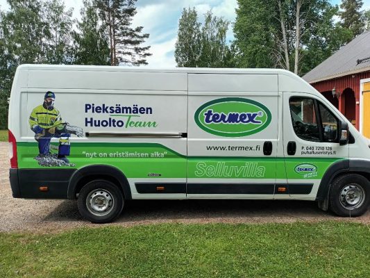

    Just to finish off this post. I completed the van yesterday and the material was “better” than previously used on the lorry (same material) but still more grab than i would expect.
    Its was a bit of a challenge as the bottom stripe was supplied in one piece, it had to be laid horizontally because of the crease in the bodywork and wifey was not around but it got done as usual.
    Overall very happy with them and an eye catching design.

    26 June 2023 at 00:54
    Thanks for completing the post thread and showing pictures, Martyn. much appreciated mate. 👍
    [ Mid-range Wrap ] – [ 2D Wrap ] etc. etc.
    It is my opinion that these are terms used by some manufacturers that cannot manufacture Cast!
    Cast is the only true grade of vinyl that should be termed as a wrapping film, and even cast has its limits on where and how it can be stretched.
    Do not get me wrong, some quality polymeric vinyl can and do conform to recesses, the one shown on the side of your van is a perfectly acceptable example of a recess for this vinyl.
