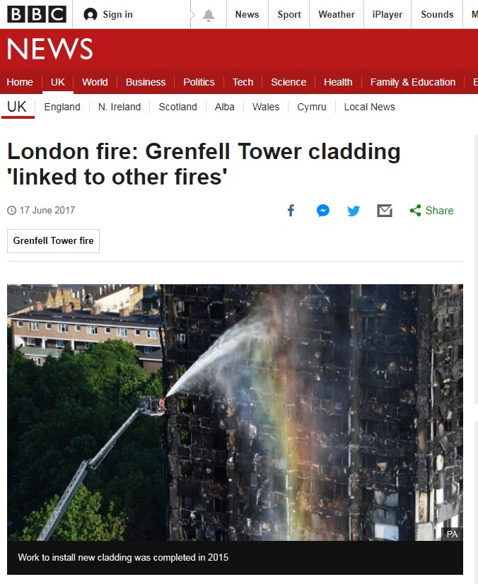

  • Peter Wynne
    15 June 2017 at 11:18
    According to this BBC news report, it would seem that it was indeed a polyethene core;
    http://www.bbc.co.uk/news/uk-40283980
    Be interesting to see what happens going forward regarding the use of such panels…
