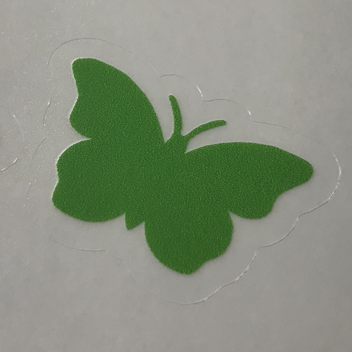

    Hi, not long had my BN-20 but I am liking it so far. Only issue I seem to have is when printing lighter colours such as the in the image I have attached. Not sure if I’m just being really picky or not but it looks a bit too grainy to me for a £5k machine?
    Is this a settings issue or am I expecting too much? For reference I’m printing onto transparent vinyl with a white bottom layer first.

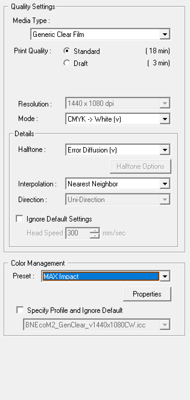

  • Robin Summers
    12 January 2018 at 15:01
    For reference please see the attached picture for the settings I am using.
    Thanks.
  • Chris Wilson
    12 January 2018 at 15:10
    Change the preset to sign & digital and find the correct media profile for the media your using.
    Our reds were worse than this but a bit of playing around and much better

  • Andrew O Brien
    12 January 2018 at 21:06
    Looks to be a profile issue. As Chris said find the correct profile. Profile for metamark md5 is a good all rounder
  • Robin Summers
    13 January 2018 at 12:12
    Thanks for that info Andrew. I have had a play and have definitely got better results now 🙂
