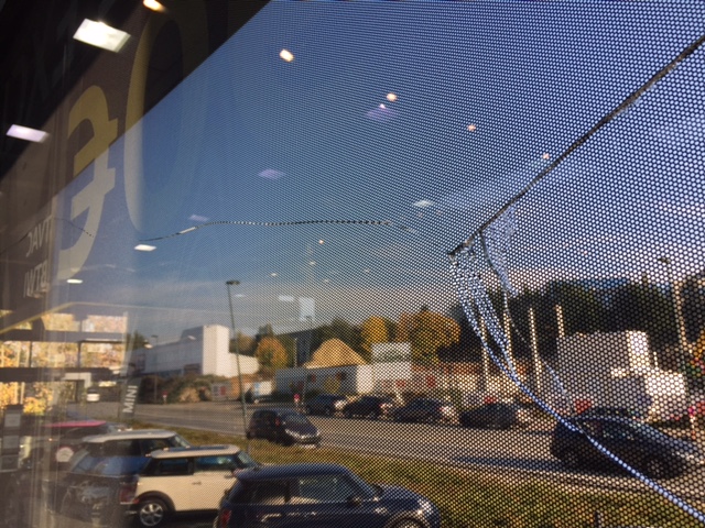

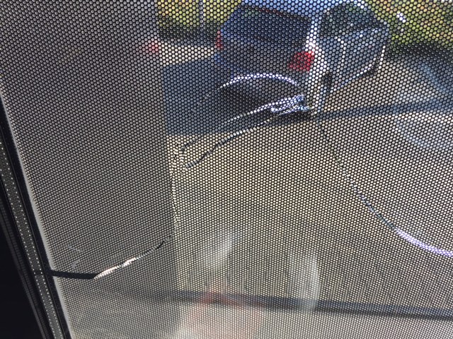

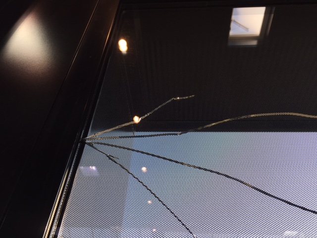

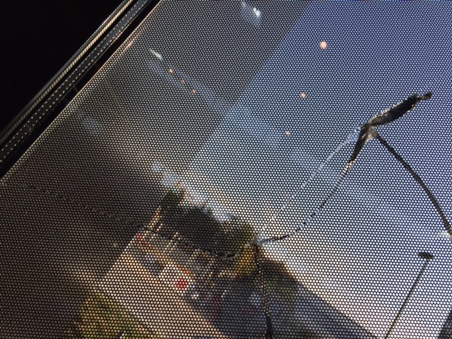

    Hi,
    We placed 15sq/m of perforated film on a 5x3m window with double glazing.
    We placed on the outside of the windows but everything exploded from left to right, should a thermic explosion.
    I know it can happen with normal vinyl of even tinted glass, but with microperforated ?? I think it is made for that application isn’t ?
    The brand of the film is : CONTRAVISION WBPRG40 / 40% transparency
    Some advices, comments, help ?
    Thx,
    Lionel

    Depends on the print. If it’s dark or black then it’ll absorb and transfer the heat regardless of the perforated media.

    We mesured the temp difference, indeed the dark is about 15 to 20 degrees hotter than the white … but what makes a window explode is the gaz temperature inside the double glazing, not the window temp itself. It can go up 90°.
  • David Rogers
    14 October 2015 at 08:00
    It’s not really the temperature it experiences but rather the different thermal stresses due to its low toughness & thermal conductivity and high thermal expansion.
    Glass thermal shock happens when different parts of the glass expand by different amounts. When the stress overcomes the strength the glass either the external pane will explode due to the heat pressure build up, or more commonly the internal pane will crack. Weak points from minute imperfections in the edge cutting will just get stresses too much. it’s not actually the gas pressure.
    Today it may have been 15 degrees – but on a hot day / direct sun the difference between white & black areas could rise to over 40 degrees…it expands, the white doesn’t and you get massive forces at a molecular level – totally unstoppable.
    Only toughened or tempered glass has a chance – normal glazing not so much. There’s no way round it except very light designs.

    Just a little update about the issue.
    My supplier came to site the do a visual check on what was going on, and a couple of days later a tech representative of Contravision (the manufacturer – contravision.com) came from Netherlands too … What a customer-service! 🙂
    Of course my customer was impressed … and here is what they (Contravision) said :
    – 200% sure it is NOT a thermal issue
    – 200% surr microperforated film doesn’t explode windows
    – Black part of perforated film can quickly go up in temp but not enough to explode a window
    – Thermal explosion goes from top to bottom (vertically), in my case the window have cracks from left to right (horizontal)
    – Problem should be window placement (too much tension)
    On the other side of the street (apprix 100m) there was some building construction, and they made some fondations at the time the window cracked. It’s was the cause of the explosion, this caused some micro vibrations and the window didn’t moved enough due to film on it (all was covered).
    Hope it helps …
