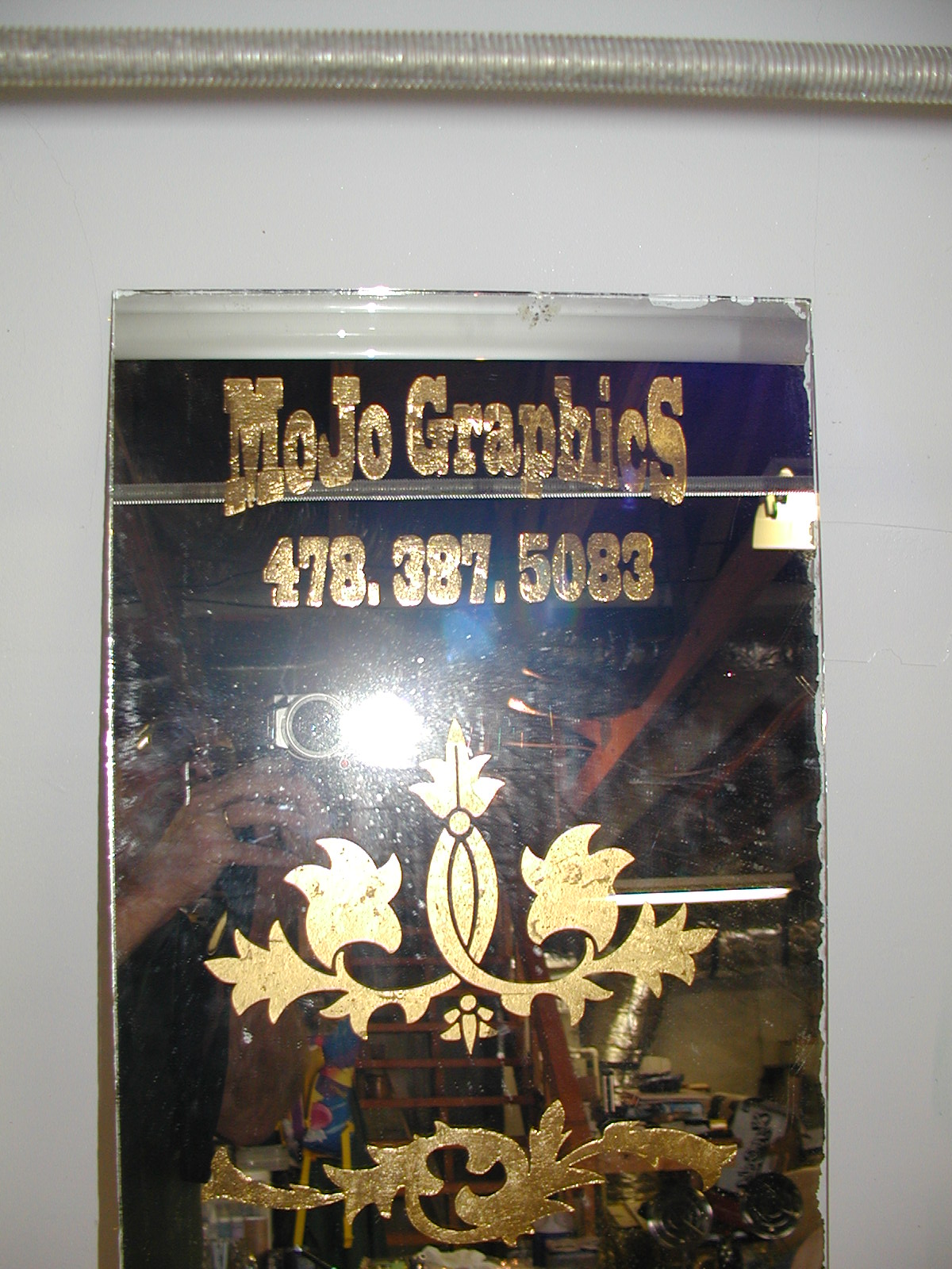

    Hey guys, and Jill. I thought maybe I ought to explain myself better as to what I’m doin’. I am actually gilding the design on the back side of some mirrors, where when you look at/into the mirror, you see the design inside of the mirror. That is why I was looking at the water gilding to maybe get a little clearer looking gild, when seeing it through the front. Although, my initial attempts have been pretty clear with the oil size, the major difference has been the leaf itself. I have used some imitation leaf, some Swift 23.5++, and some Thai leaf from e-bay. You probably don’t want to know which is the better looking. Here’s a pretty bad picture, I’l get some better ones, didn’t know mirrors were so hard to photo. Thanks Mike
  • Neil Davey
    26 January 2009 at 10:23
    Hi Mike, you have a very mottled finish on this gild due to the oil size not laying flat I guess, more than likely a little too thick, needs thinning.
    With a water gild the gold will lay dead flat and will give a mirror appearance of it’s own.
