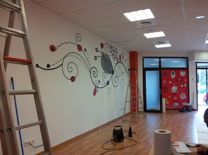

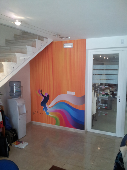

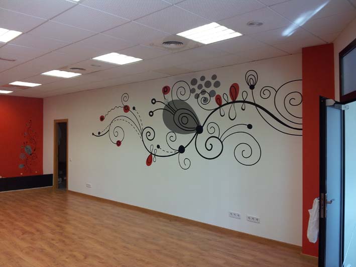

    Hi Guys,
    just a few of quick photos, and to say thanks to those that helped me pick the correct materials.
    Wall vinyl – 585cm x 175cm – hexis eurotac matt
    Wall Paper – Mactac deco satin.
    We found both great to apply, quick blast with heat gun and they were very well stuck.
    Dan

    Is the mactac stuff self adhesive?

    Hi John,
    yes print it,peel it and go! Seal the edges with seal it pen and your done! We think its great!
    17 June 2012 at 18:48
    are the swirls etc not cut vinyl then Dan, all printed?
    why do you need an edge sealing pen?
    sorry, im new to wallpaper graphics etc been doing some homework and getting samples for months now so just asking out of curiosity?

    Hi Rob,
    swirls etc cut vinyl, the printed wall paper mactac recommended sealing the edges/joins with the sealit pen. Phototex is a material you should get samples if you haven’t already, it is similar to mactac but doesn’t require the edge seal, but also is removable and can be stuck on different texture surfaces.
