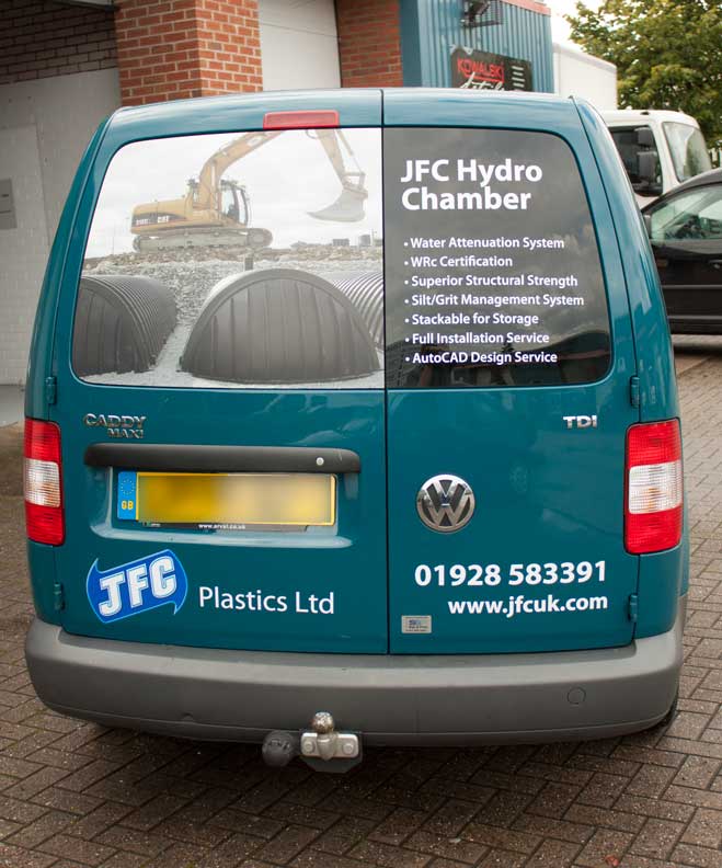

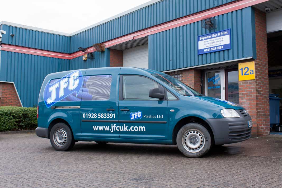

    A VW Caddy Maxi.

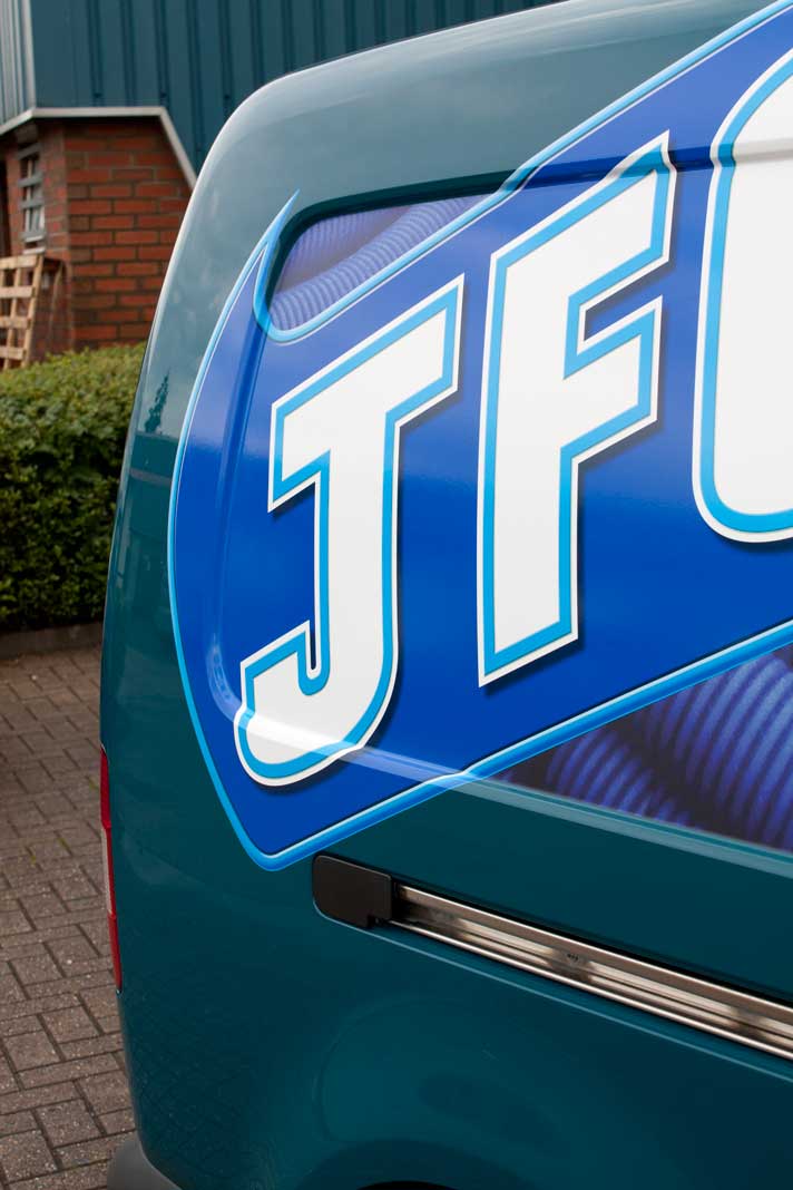

    I used Metamark MD5 with air release with Matt laminate for the panel infills, and 3M IJ180 with gloss laminate for the oversized logo (Thanks Gill from William Smiths) Oracal 551 for the white text.
    The logo is really bright and vibrant, the 3M laminate was really glossy, so decided to mix it with the Matt laminate for added effect.
    All went well flood coating the panels, had a complete memory lapse when it came to fitting the first over sized logo, but was testament to 3M’s Controltac, as it was on and off several times.
