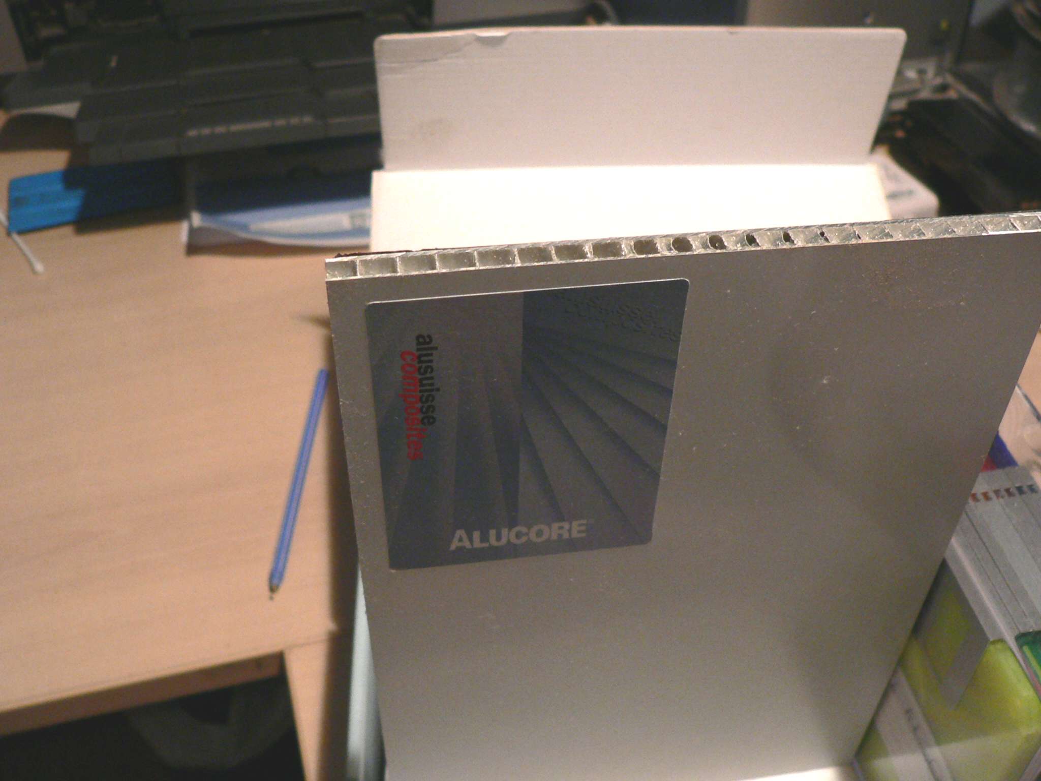

    Is the material you are talking about similar to this?
    If so it was probably not necasary for a sign like this I would probably just have used dibond and stood it off from the main board.
    Would work a bit cheaper also
    Peter.

    Yes the alumalite is just corrugated plastic with aluminum stuck on each side.
    Another question I have is about the edges of the print/together with the sign. I like my signs to have full bleed with the prints all the way to the edge with no white space showing. What is the easiest way to acheive this? In the barbeque sign that I did, how would I have made it from almalite with the print all the way to the edge? Is it okay to apply the print then cut with a jigsaw? I was afraid that this might damage the edge of the print and cause problems. I like to use custom shapes but I’m already seeing problems doing this with the printer. Any advice would be greatly appreciated.

    think the material liegh was talking about is this
    http://www.bayplastics.co.uk/Product%20 … Panels.htm
