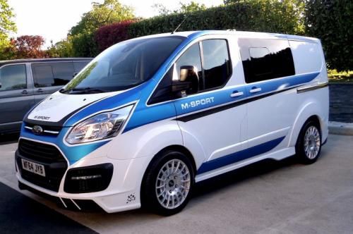

Posted by Andrew Smith on 26 February 2021 at 12:56Hi all,
I am looking for a little help.
I have been asked to make and fit a Ford M-Sports graphics kit for a Ford Transit Custom 2021 LWB Is there anyone who has the artwork to reproduce these
I don’t normally do this type of work but he is a good mate.
any suggestions?

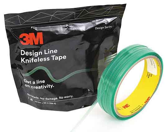

Knifeless-tape all the way!

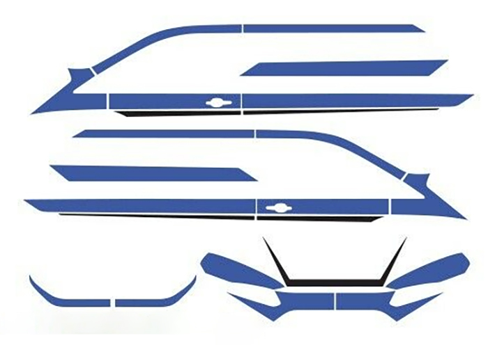

Templates are great if you can get hold of an accurate one, but who will have an accurate one and simply give it away? I know I wouldn’t!
I have been asked for this type of thing a few times now but I haven’t done any yet.
I can use knifeless tape but I can’t make it do this type of thing and even if I could, I think the time it would take me. would far out-weigh what I could charge! 😳
I did try finding a template online but there does seem to be lots looking but none successful. -

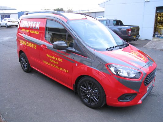

That looks great Phil!
Had you been using the tape a long time before trying something like this?-
I did another van the same as this previously, and that was the first time I had used knifeless tape.
You follow the body contours where they exist, and I used 25mm application tape to mark out the space around the headlights. Then the rest was more or less done by eye. The hardest part is making sure both sides are symmetrical

Thanks Phil, I think my worry is that over that length or size of shape that the tape might fail or cut wobbly or something and the whole thing is wasted. maybe i am over thinking it. 😣
I used to have the same fear -but the knifeless tape works very well. You just have to be careful
