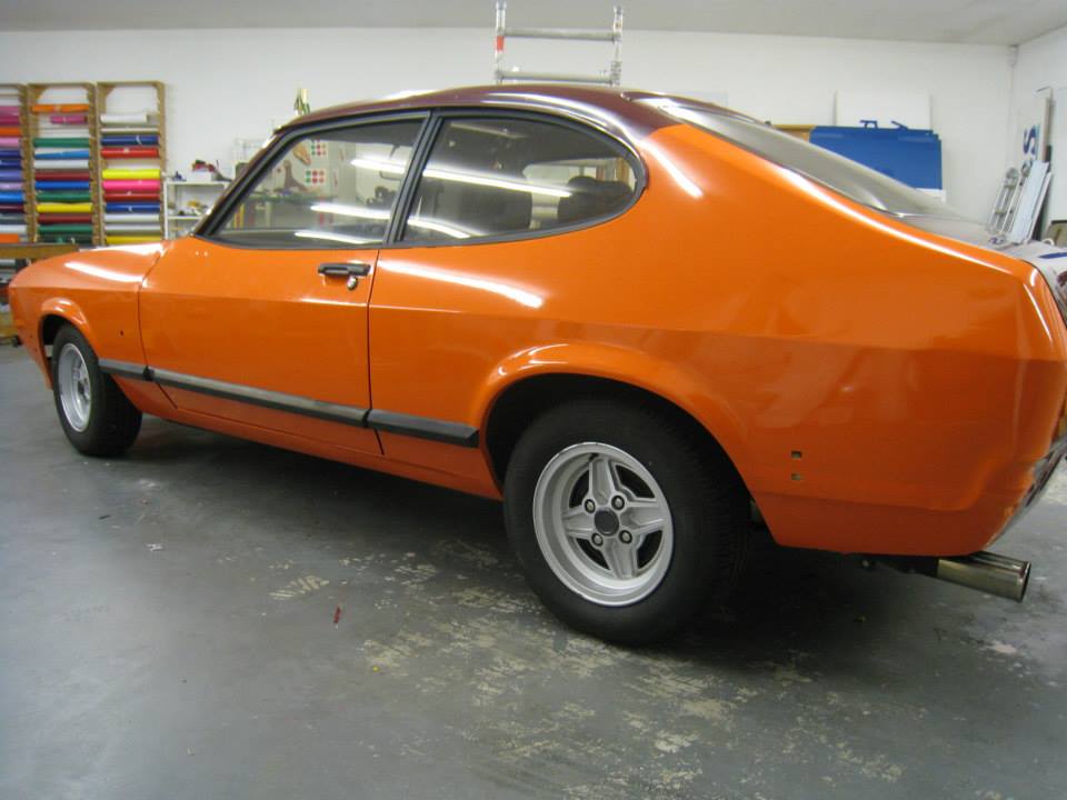

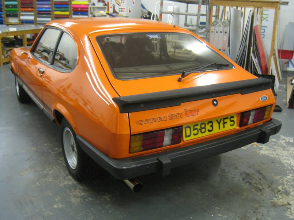

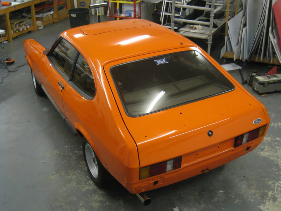

    What does a sign maker do when faced with filling the void that is the Christmas and new year holidays? Well he goes and wraps a Capri of course. (well it gets me out of the house) 😕

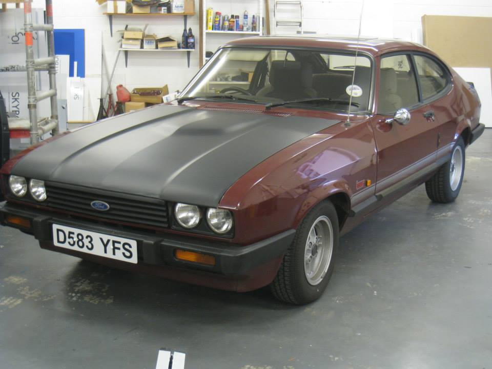

    Looks awesome Phil! Love that colour with the matt bonnet!! How long did it take to complete? 😀
    5 January 2014 at 20:30
    Looks great Phill, is orange a colour The Capri came in back in the day?

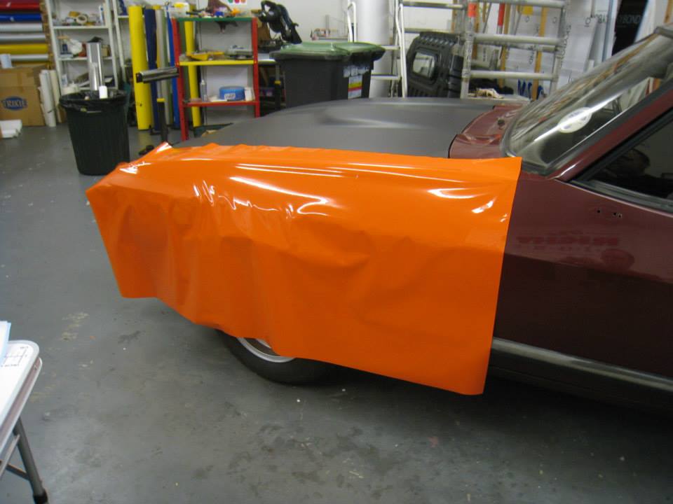

    Looks good, what vinyl have you used???

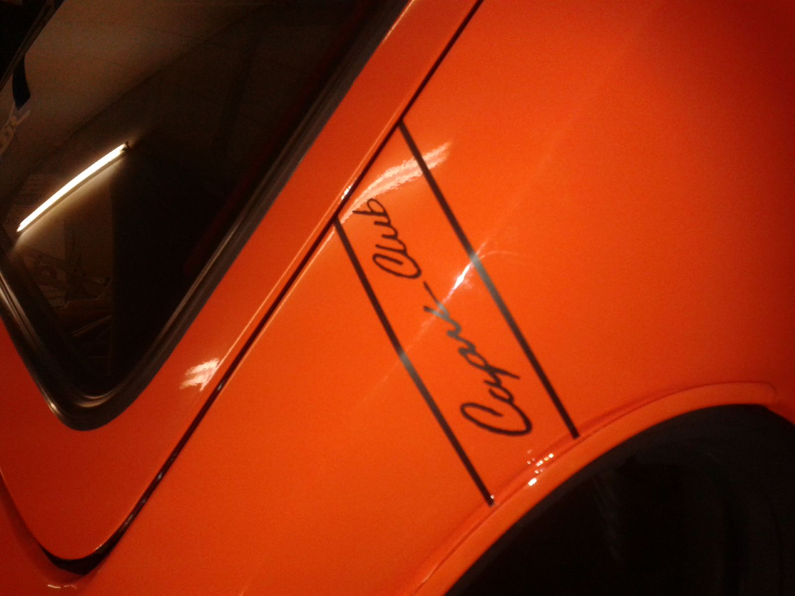

    Noticed the unavoidable join on the back pillar there.
    Bit of a nightmare, I have to do a Bentley GT Continental this week and have exactly the same issue. so i am trying to come up with a work around. 😕
    5 January 2014 at 20:55
    I started it on new years eve, and spent a few hours every day (apart from yesterday) and finished it today. My particular model of Capri never came in orange but there was an "S" version that was popular in orange during the late 70’s early eighties. I used Avery supreme vinyl which I find easy to work with.
    The Capri is one of the few cars that don’t have a natural break somewhere between the roof and sides so I made the join at the narrowest point on the rear pillars and have disguised this with a thin matt black stripe and the message "Capri Club" applied as a vinyl decal. You can just about make it out on step 8 and 9 photos.

    Here is how I disguised the join on the rear pillars. The black line above the lettering sits on top of the overlap which means the seam cannot be seen
