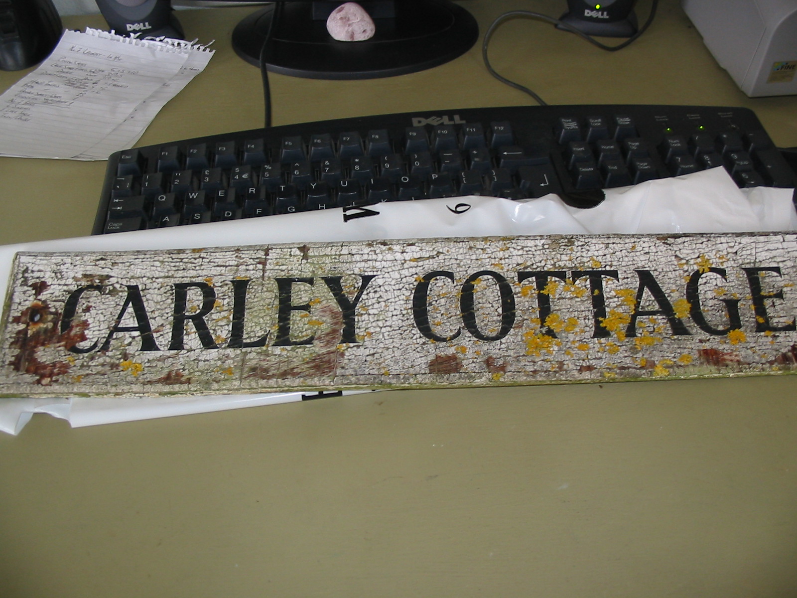

As I’m sure you suspect, this is a handpainted sign. I don’t think it’s a font as such.

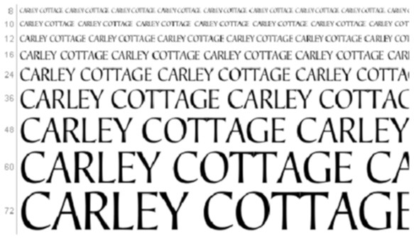

This is similar but not identical.
Its called Corvallis Sans
http://www.myfonts.com/fonts/agfa/corva … llis-sans/I’d just varnish that, its beautiful…….I spend hours trying to get that effect in Irish bars! 😀 😀

Yeah I know it’s nice the way it is with the crackle paint effect and the lichen growing on it…but it is really light and about to fall apart cause the wood is so rotten….
I was asked to make two replacements that last outside for a good while. They can keep this one indoors maybe? 😀On the subject of long lasting. I was hoping to get some teak or iroco. Any other timbers you could recommend for our lovely damp climate?
