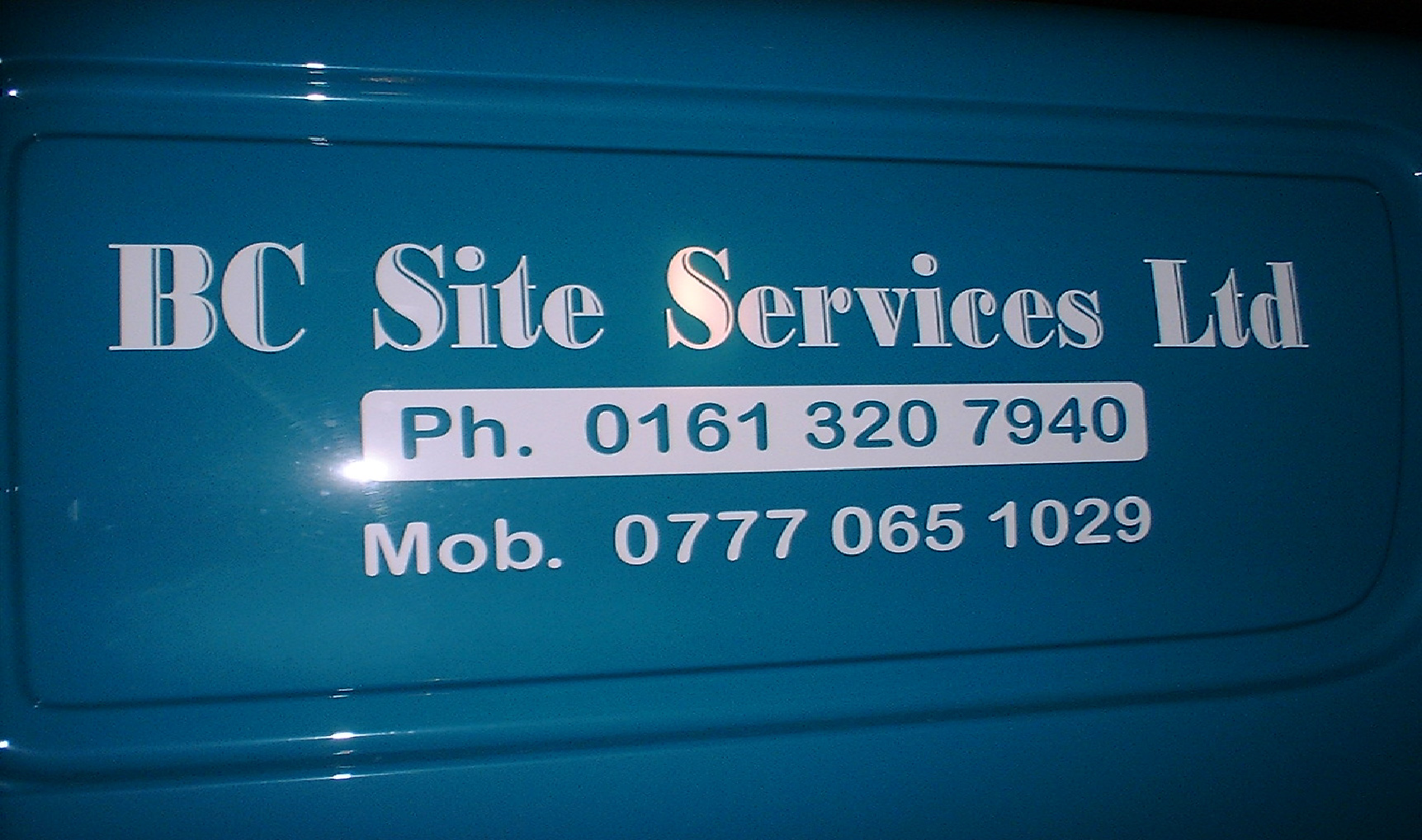

    Looks like Bodoni Black.
  • Myles Brewer
    10 January 2006 at 23:59
    yeah it’s certainly very similar but it dosn’t have the cut out bits
  • Nancy Wannous
    11 January 2006 at 00:02
    I know its from the family typeface but i don’t have access 2 it. ill have a look for you there is like 20,000 font to go through .

    Myles.
    No luck yet
    U can always create the lines with offset path in illustrator
  • Ramj
    11 January 2006 at 00:34
    how would you create those with offset path, would you offset one inwards, and then duplicate it and use the pathfinder to knock it out?

  • Nancy Wannous
    11 January 2006 at 00:42
    After creating fonts to outline yes
    Click < Object <Path < Offset Path.
    Then use Pathfinder or divide objects below. there is a lot of ways.

    Myles, this may sound obvious, but we do a lot of repair work.
    Phone the owners of the vehicle, and ask them for the number of their sign makers. 9 times out of 10 when you phone them, and explain that you are doing a repair job (for your client) they will quite happily email the bit you need.
    Sometimes though you may get an idiot who thinks that you are stealing his work.
    If all else fails, do a rubbing and/or take a better picture and trace/vectorise

    Myles, if it for an insurance bodyshop repair, and you dont get the co-operation of the original sign maker, just do it in the nearest match font.
    insurance will be happy, and in the unlikely event that the owner notices the difference, the bodyshop just explains that his signman would nor co-operate. Only do the one side though, trust me no one will notice.
  • Myles Brewer
    11 January 2006 at 01:08
    peter,
    not insurance job but your right , nobody can see both sides at once so similar font would proberbly do , i have something like but not as thick, it’s just i’m a taurus so tend to be a bit of a perfectionist & like to get it right if i possibbly can, will try original signwriter tommorrow if i can. thanks

    I agree with Peter. Caslon is a match.

    Caslon is one type face i saw and i though it was close match.

    Sorry Nancy, I disagree, Caslan is much more open. Myles, I never did find the text I needed, although it was sure as hell the same as you are looking for.
    Fortunately I only needed the 3 letters, which I used the Bodini fonts for, and drew the ‘open’ lines myself. Bit more difficult with yours.
    ‘What the font.com’ didn’t come up with the correct one either.
    I’d do as suggested, and get customer to phone previous signers.
    Good luck 😕

    The font is “Bodoni Highlight”. I think I have it somewhere, ill look when i get a minute…

    yeah lorraine, coslon is a bit too thin as are the rest i have, ta anyway

    just searched & Googled, Bodoni Highlight only available to purchase….

    Hi Myles,How r you today. Do you have access to a better photograph i can add the highlights for you working from the BODONI BOLD text. Ill do it now and wont take me long 30 minutes max. Let me know.Nancy
  • Myles Brewer
    12 January 2006 at 13:03
    Hi Nancy , Sorry that’s only foto i got, thanks anyway
