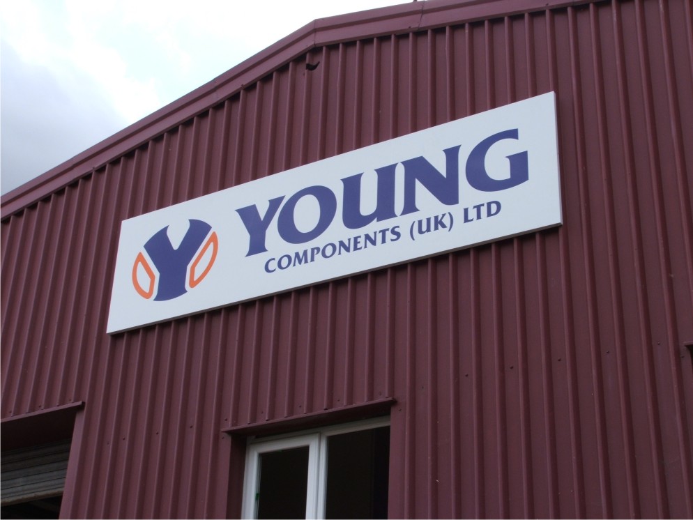

    Just a bog standard tray, but I did finally get round to trying a v shaped bit rather than a straight one. Much better result. All the folds, especially the corners, are much tidier.
    Anyway, the sign is 4.5metres long and is about 20 feet up, so that makes me especially mental for carrying it up a ladder.

    Looks neat Andy. :thumbsup: You didn’t lug that up a ladder on your own did you? 😮
  • John Childs
    31 August 2006 at 08:27
    quote Marcella:
    He’s a tough little bugger Marcella. We breed real men down here in the Midlands. 😀
    Nice job Andy.
  • Richard Urquhart
    31 August 2006 at 08:59
    Andy nice job mate would like to try a v bit but as i have done a few with the round bit and no problems i have got used to it, however you say its better so one day i will get one
    and as for getting it up there your NUTS i hate going any higher that 6 feet !!! 🙄 🙄 🙄
    31 August 2006 at 09:01
    nice looking sign andy 😀
    yeh…you are nuts doing that up a ladder 😉
  • Andy Gorman
    31 August 2006 at 09:16
    Thanks. 🙂
    Richard, if you do use a v bit, make sure you grind a flat spot on the point 3.5mm wide. It looks massive but is just right to give a perfect fold.
  • Roy Roffey
    31 August 2006 at 17:54
    word of advice Andy,
    i know a guy who went around fitting signs at height on his own and ended up falling 16` and breaking his foot and ankle on the way down.
    DON`T TAKE THE CHANCE mate – its not worth it !!!!
    by the way – my foots OK now but i got a bit of a limp and get my lads to fit signs now.
    any way great work pal, i need to perfect my corners on folded trays also 😕 😕
    roffs

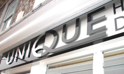

    Nice job andy, I have started to use the ally returns from SMP for making trays from dibond, not as much mess and dust and maybe a tad quicker
  • Richard Urquhart
    31 August 2006 at 19:34
    ah peter tell me about the mess little bits of aluminium and plastic all over the place even in my socks
    i have seen the returns you use and this way you can do ovals if im correct
    do you have any pics of the one you have made
    rich
    31 August 2006 at 20:10
    Rich the last ones I made I did radiused corners. but I never asked SMP how to do it I just assumed that you cut away the alli to allow it to be bent, it took quite a lot of time to do, but there may be a quicker way.
    Here are some pics that I posted earlier
    http://www.uksignboards.com/viewtopic.p … uba#134404
    There are a few close ups if you scroll down
  • Richard Urquhart
    31 August 2006 at 20:17
    very nice
    how do the returns fit to the edge of the dibond
    when the returns are fitted can the sign be fitted like a tray i.e screws from top and bottom
    only worrie is if you can fit through the returns then its only the returns that are screwed
    am i making sense
    thanks mate
  • Richard Urquhart
    31 August 2006 at 20:19
    peter sorry mate just looked at your first post and you give a great description
    also sorry Andy for hijacking this post
    31 August 2006 at 20:20
    The returns are glued, and yes fitted like a tray, a screw each corner with a white cap (number plate ) finishes nicely.

    I found SMP’s Returns very handy on this small shop frontage.
    There was very little depth to the frontage and an overhang of timber above. So I made up a timber frame and fitted the Return on the top edge prior to fitting the frame.
    This was my first shop front, I have played around with making my own trays since & find SMP’s return way quicker and gives a very nice finish.
    Tim.
  • Richard Urquhart
    31 August 2006 at 20:41
    nice work and good use of the return being fitted that way
