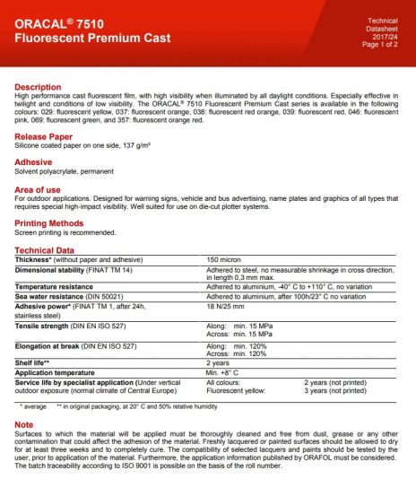

      I’ve gone back to the supplier with the spec sheet the Rob posted and challenged their response but I don’t expect anything good back. I will note that this was the satin version that Rob mentioned and not the gloss version, perhaps I should look at that.

        I’ve been using the gloss version Dan, so may possibly be better,
        Since my last post my delivery turned up and they have sent me 6510 not 7510 which I ordered.
        I’ve had to fit it as customer cant wait, ( spec says short term outdoor life 😠, so will be interesting to see the outcome of this)
