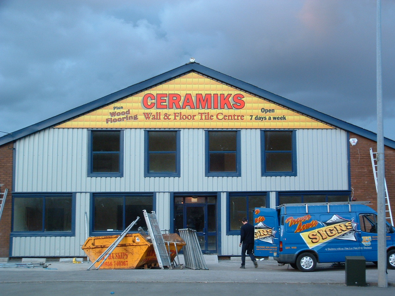

    Nice banner Mike, How was it fixed to the frame?
    do you have any worries with expansion/contraction if its not tensioned?

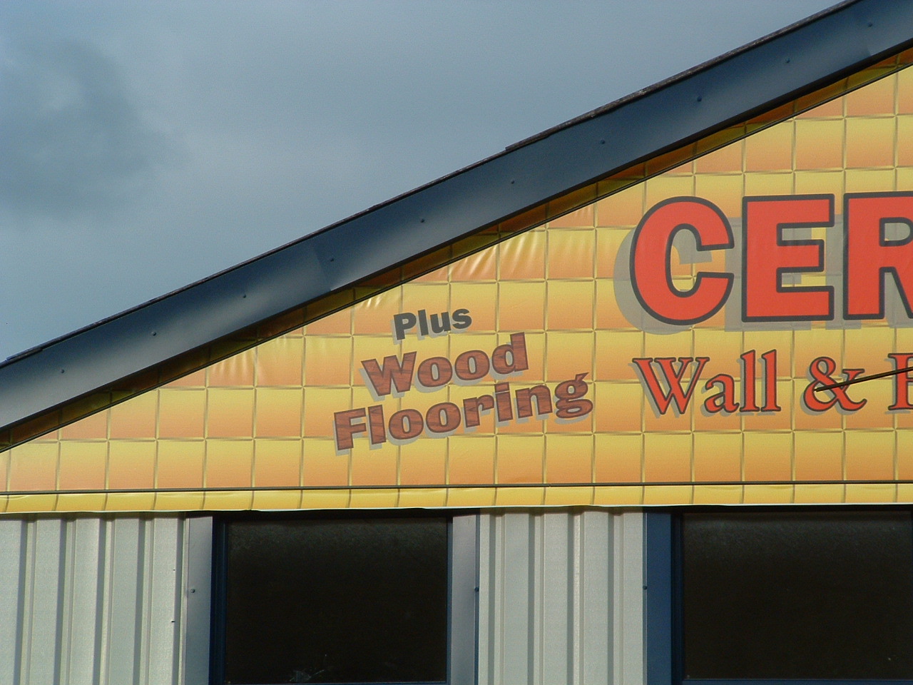

    These wrinkles couldn’t be seen from close up, so we had to go back and re-tension it.
    sorry Mike, you did say flex face, didnt read before I opened my gob

    All done in 7 hours by 2 men. I was so glad the weather was with us. 😀

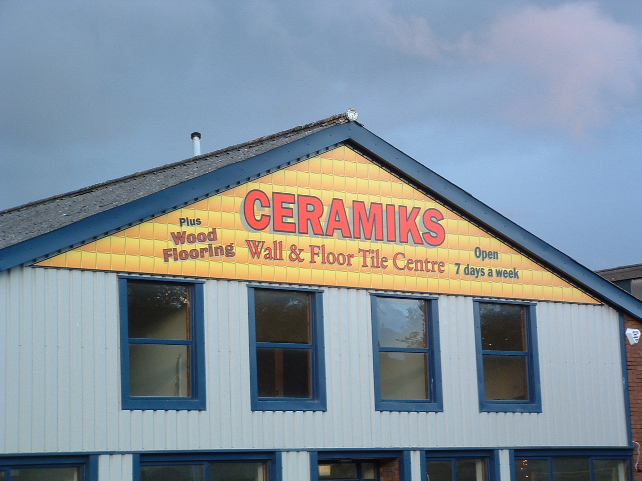

    Nick, no we didn’t print it, much to big for our machine. It’s 12000 x 2400 and liquid laminated. I hope it will last as it faces the sun all day. 🙄

    i wondered cause i didnt see any joins…looks good though 😀

    at tip: those wrinkles…. wave a heat gun over the area of the wrinkles, dont get too close or puase… the skin will tighten up itself and wrinkles will go fast…
    that said, depends how severe the wrinkles are, from the picture and from what you said (couldnt notice up close) then these are the ones that can easily be taken out with heat gun.

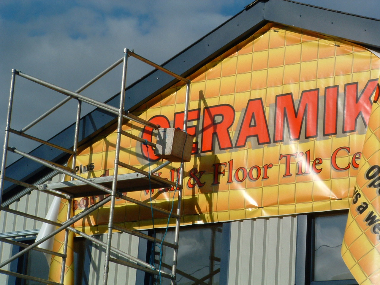

    I can’t remember the company name for the frame (getting old) but the system is called "Crystal" We purchased only the frame from them, they were at Sign UK this year.
    It is a fantastically simple system to use. Just a plastic beading that you hammer into the track that jams the banner in place, very easy to remove to re-adjust the banner. You have different tracks on the aluminium rails to either fix from the sides or directly from the front as we did as we only had a 2" gap around the frame.
    The wrinkles were easy to remove when they had been spotted but we did leave some very small ones that were a bit stubborn. Rob as it happens the company that supplied it to us also mentioned today about heat shrinking the wrinkles out. Pity we only find that out after (?)

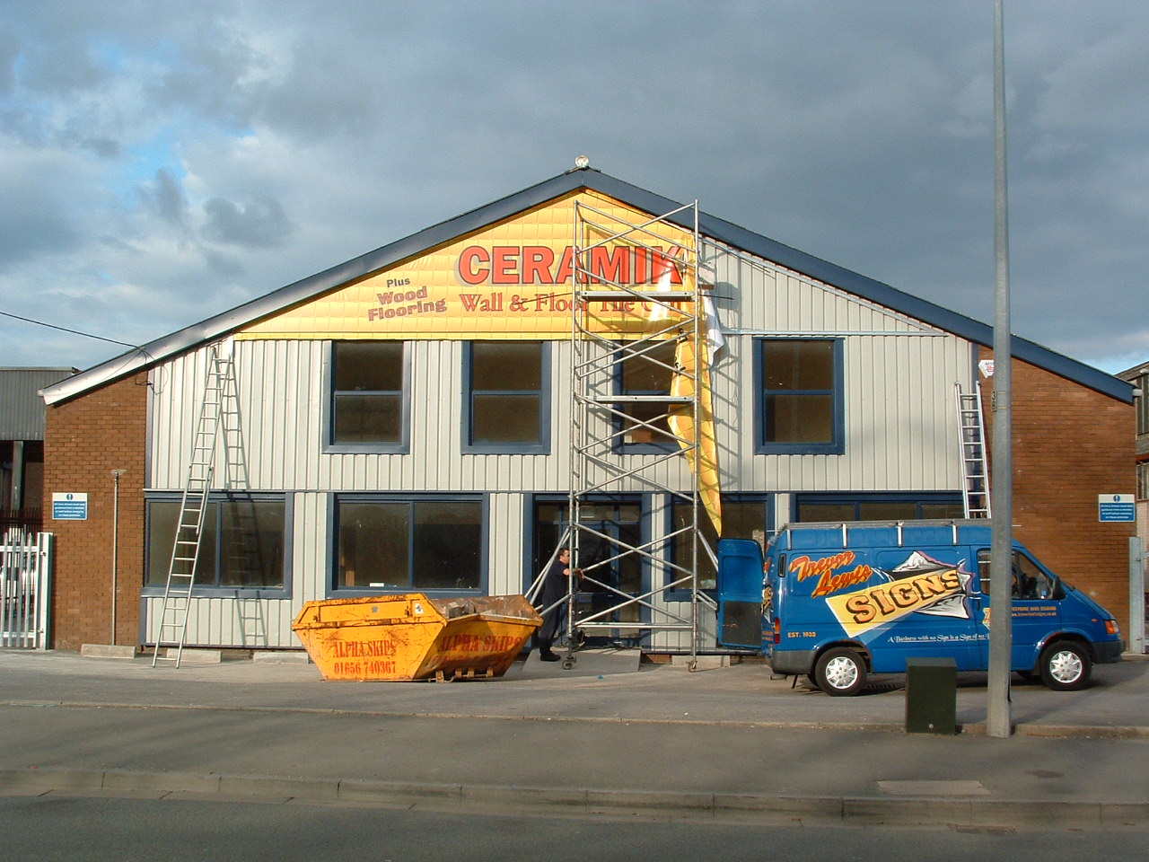

    Cheryl the pictures are decieving as it was windy, check out pic 114 you can see the tail tucked into the ladder rungs to stop it flapping.
    We printed it 100mm larger all round for handling, then when we were happy with everything we trimmed it down to the plastic strip for a nice clean finnish.
    My biggest concern was getting the panel perfectly horizontal as if it run out of true you would notice it because of the tile lines. We started at the apex, that wasnt in the middle as it was 115mm to the left of centre, but I done all my home work first to eliminate any errors, then up the ladder to lightly tack the banner into place along the baseline before putting the long strips in. Made about 4 passes back and forth to get everything right. My muscles were totally shot by the end of the day with all the climbing. 🙄

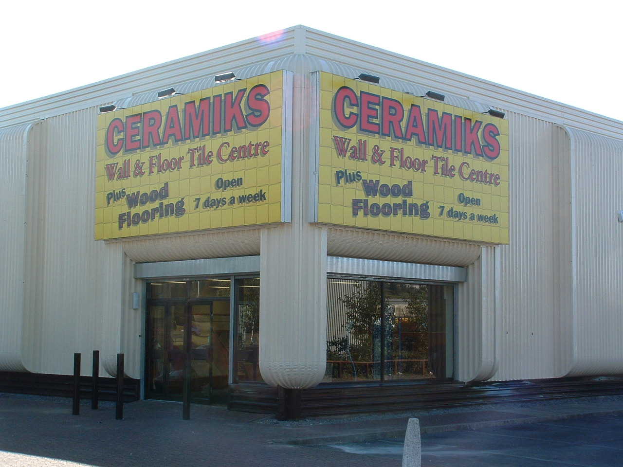

  • Mike Grant
    6 October 2006 at 20:42
    Here is the original one.
