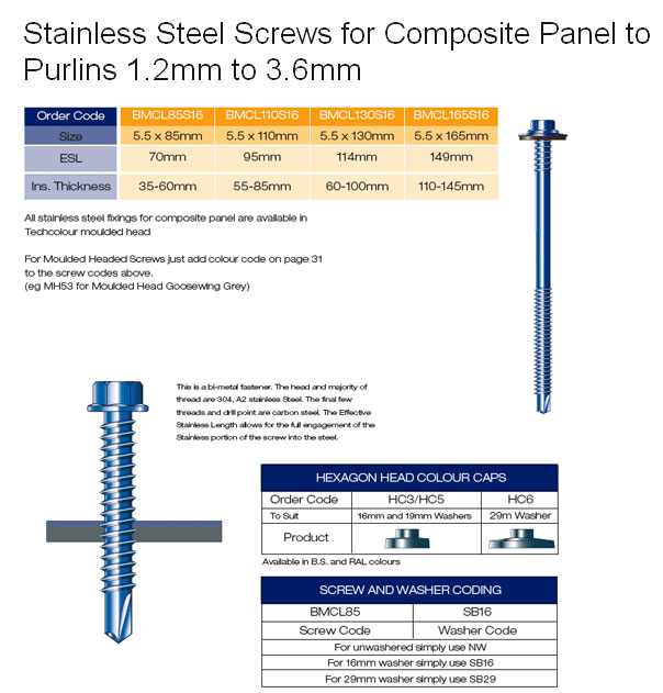

    2 days ago I purchased ;-
    1500 no. Tech screws for fixing into aluminium and similar soft metals.
    400 no. Tech Screws for fixing into steel.
    400 no. Tech Screws for Fixing into wood.
    I have also attached to this post, part of a PDF based on Techs made for fixing “composite” to steel framing. Same applies when fixing Composite to the cladding, same screws, different thread because the cladding is a softer metal.
    The techs large hex head is to help spread the load. The rubber washer is there to allow movement of the panel as well as preventing the screw from loosening.

    So the answer to Harry’s tech screw question is “YES

    Rob
    we appear to have a difference of opinion,
    so do you fix panels to the cladding or the purlins?
    you have shown the screws that fix to purlins, which is the ideal way to do it for maximum strength, they have a small head and no washer, the ones with a rubber washer are for cladding to purling, the washer is to make a watertight seal,

    quote Peter Normington:
    Rob
    no peter, i fix directly to the cladding. if i ever feel the need to tap into the steel frame work i can. i simply change the screw, using the same bit, and drive in that tech.
    unless you can fix direct to the framework. with the screws that rob has pictured, but you would need to know where the purlings are, and usually go through insulation and an interior layer as well, Peter
    another naive comment peter…
    cladding buildings are riddled with tech fixings holding the cladding in place.
    where there is a row of techs, there is a length of steel running behind the cladding.
    the image attached was not to show you what i use peter, it was was to contradict your last comment that techs are only for fixing cladding to steel framework. the image shows they are also specifically made to fasten "composite", not all, but mostly the head section of the tech stays the same, it is only the threads of the tech that changes dependent on what it is taping into. e.g. the thread on steel taping thread is tight and shallow. the thread on a tech for wood is broad and open.
    I actually use "WOOD" techs to fit huge illuminated flexiface signs directly to cladding buildings. I have lots of them dotted all over the UK now. never have i had a problem with any and they have been up some 4-5 years now. now dont just take my word for this, I was given the "tip" by guys from a national sign installaton team first hand, i told them i was peppering the sign box with the open threaded techs and fastening directly to the cladding, but also hitting the steel framework where ever i could. i was told "not to worry" by all means use fasten to the frame work for peice of mind, but the wood techs grip and grip strong. they were right… 5mm pilot hole followed by the wood tech. (only because wood techs are not self taping in metal)
