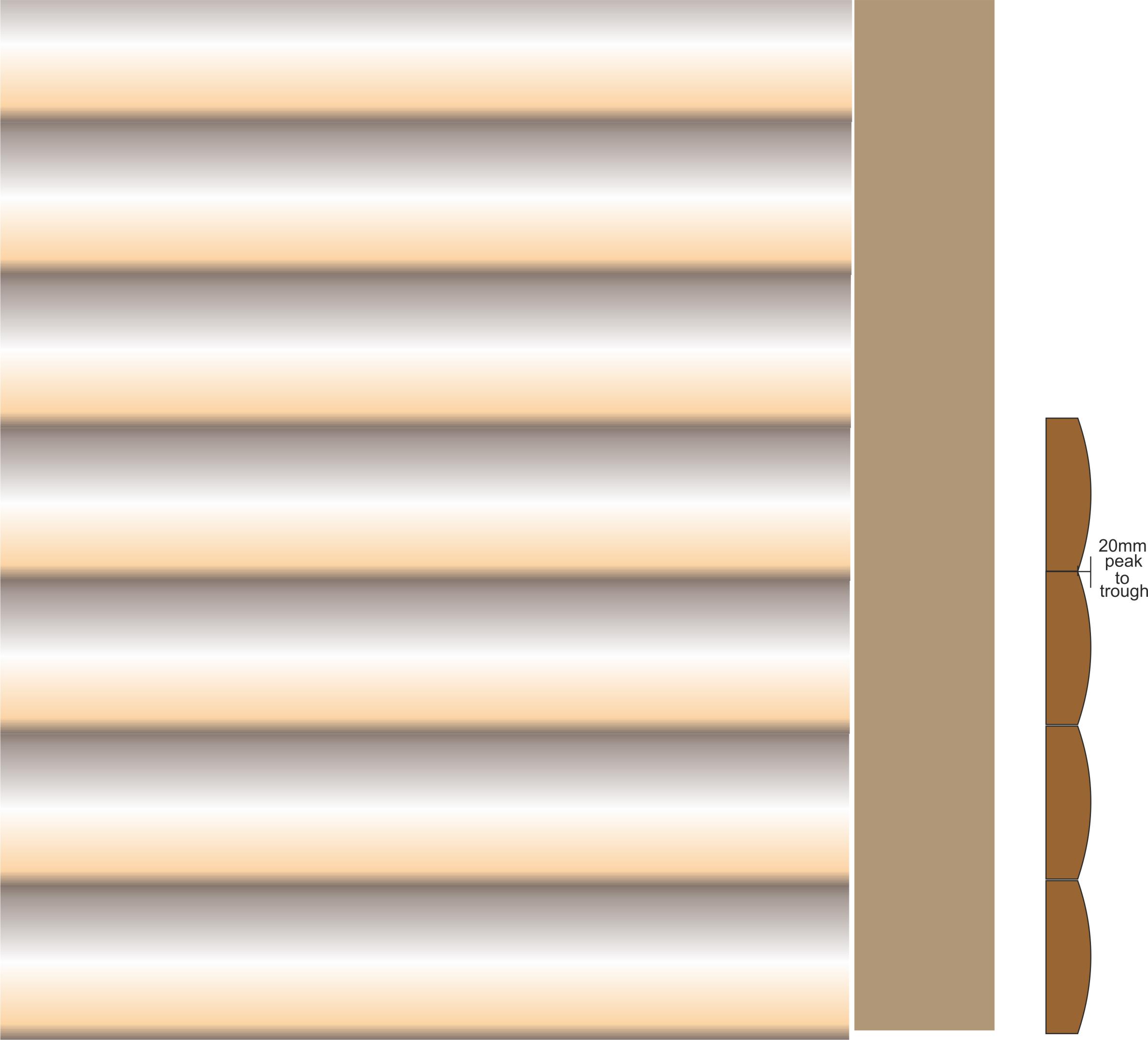

    I have some cut letters to fish to a timber building, the planks which make up the log cabin style wall are about 125mm wide with a rounded face, this means there’s a regular trough and peak, with the difference being aprx 20mm,
    i’ve quoted to put the letters in an arc, which has made it a bit mroe tricky with regards positioning the letters.
    any ideas please?

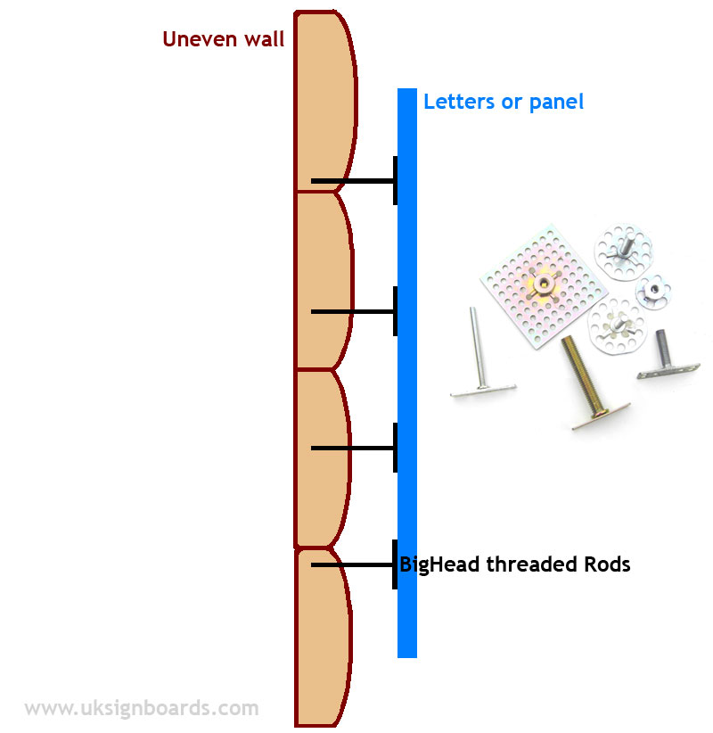

    19 May 2011 at 00:34
    As a quick easy solution…. Big Head fixings
    they have a vast array of fixings… you are after the metal threaded rod with 2p size type head with holes in it. along with fixing liquid.
    turn the letter over.
    squirt some bonding adhesive on key spots.
    press head into liquid and allow to cure.
    create paper template to show were locators are.
    apply paper template as normal, and drill with drill bit, making hole slightly deeper on risen areas.
    squirt anchor liquid bonding adhesive in holes.
    press letters "evenly" into holes. better to have a space slide down behind letter to keep depth level consistent, then slide out.
    allow letters to set.
    job done.
    i am being brief on this… its best getting proper advice from the suppliers.
    i have these and used them several times. but be sure not over buy on tubes of adhesive because they have a shelf life. i have that t-shirt too. 😳
    i appreciate buying fancy fixings and the like may not have been budgeted for. but educate your customer. tell them the normal way to do this is using this and that method, but using your advised method eliminates this and that unsightly fixings methods.
    They get what they pay for at the end of the day….

    Thats perfect Rob,
    Thank you! I’ll give them a call later,

    I’ve emailed big head but he’d no response yet, does anyone have a rough idea of the cost of these in m5x 30mm mild steel?
    M5 is a bit heavy, would prefer m4 but they only go 25mm long. Seems a lot of (big) 6mm holes to drill into a new building!
    What size would you guys use? Acrylic letters, max 170mm high.
    Hugh

    go for the threaded nut version, with m4 bar
    19 May 2011 at 18:30
    quote Ian Johnston:
    thank you Ian, I didn’t think of that, do you buy the rod ready cut? seems a lot of work if i have to cut them all but hand!
    cheers,
    Hugh
  • Ian Johnston
    19 May 2011 at 18:32
    you can get the bar in 100mm lenghts,
    easy to cut, Sharp Snips and a welt with a hammer :lol1:
