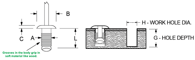

  • Stuart Miller
    1 July 2014 at 12:19
    Hi Gert
    Is it the grooved DH rivets you are talking about?
  • Gert du Preez
    1 July 2014 at 16:46
    Hi, Stuart,
    Almost. The ones we have opens up in a "petal". I presume it is almost the same thing, protected by different patents 😀
    The example you illustrated should work as well

    2 July 2014 at 01:11
    They sound like peel rivets from the description Gert, anything like this
  • Gert du Preez
    2 July 2014 at 09:45
    Hi, Martin,
    Nope 😀 Almost the same, but the "petals" don’t curl all the way round. I’ll take a picture and post it.

  • Stuart Miller
    2 July 2014 at 12:21
    I can’t see how those peel rivets would work inside 3mm ACM.
    Also cant see how the Grooved head rivets would add much to a VHB tape adhesion, but i guess every bit helps.
