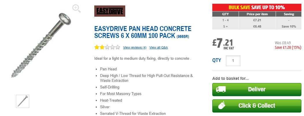

    You can use tech screws no need for raw plugs.
  • Gordon Smithard
    7 December 2018 at 17:44
    Do tech screws work on brickwork? I thought they were just for ally cladding.
  • Lee Reeves
    7 December 2018 at 18:00
    There is a masonry screw see attached, no raw plug needed makes fitting much quicker
  • Gordon Smithard
    7 December 2018 at 21:12
    Wow….didn’t know about those!
