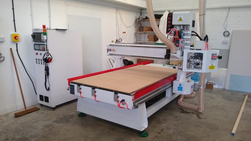

    Hi, We’ve just got a new cnc router and laser cutter installed so it’s time to up our game with regards to the signs we produce. Can anyone advise me as to the correct procedure for fitting sign locators to dibond / acrylic, placement etc. When we previously bought them in before they came supplied with a paper template with the screw holes marked on it. How are they these done? Thanks

    8 October 2020 at 23:25
