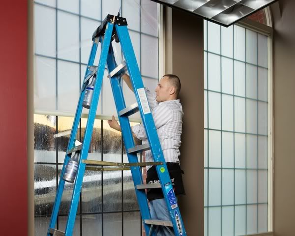

Also as its on glass I always follow window tinting procedure of 1 x sharp edge scraper and 2 x rinses before install to get rid of any dust particles or even tiny glass beads which can spoil the finished look.This picture shows how I do it although this shows tint film etch which has a very thin backing liner. Vinyl with a paper liner is more awkward to reverse roll as it ends up being a bigger roll.
