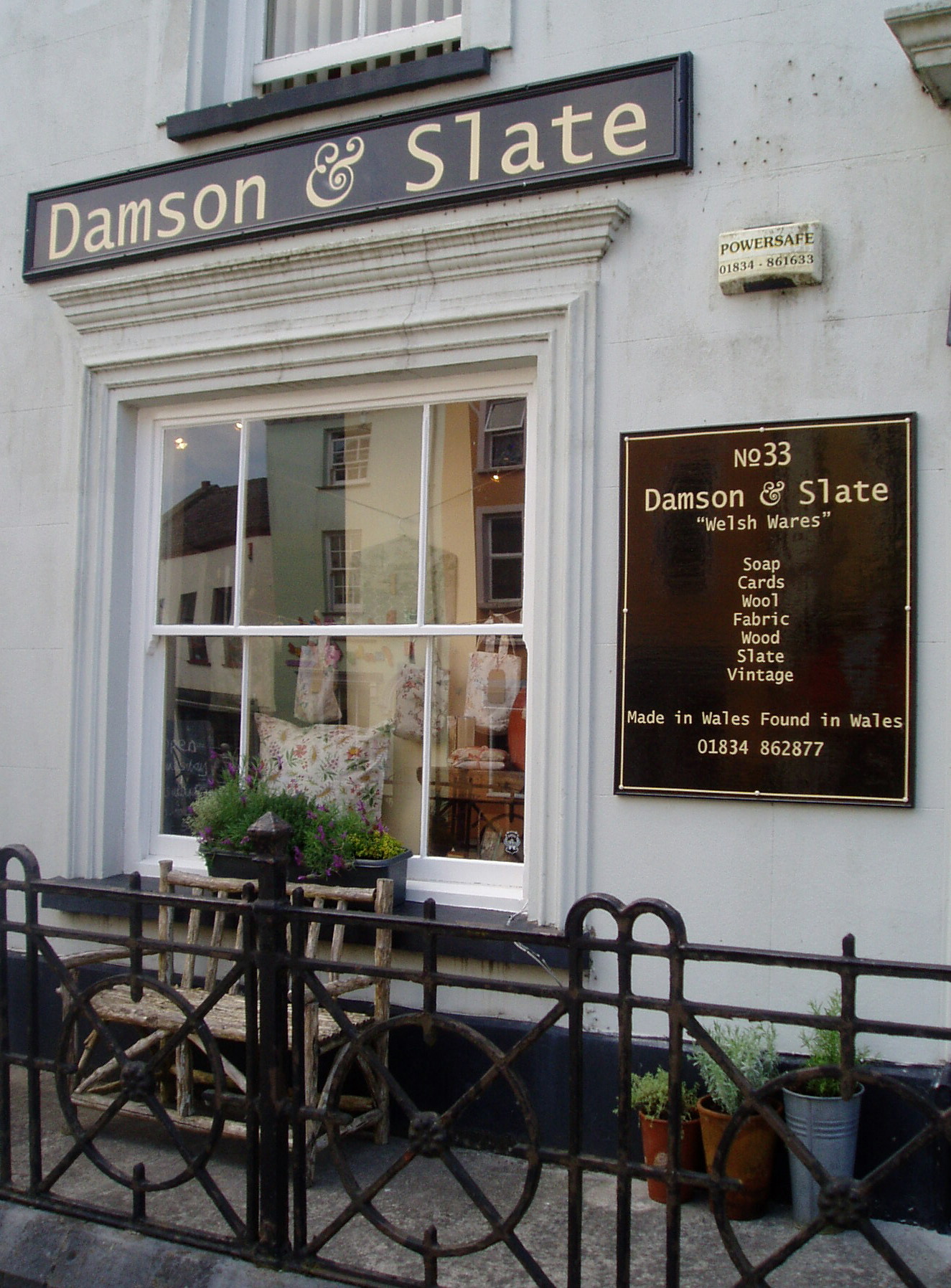

    Finished putting these two up together today. Felt like a weight off my shoulders. Learned a few lessons on the way and irritated the misses no end! Still all his happy. Looking forward to a breather between the next job.

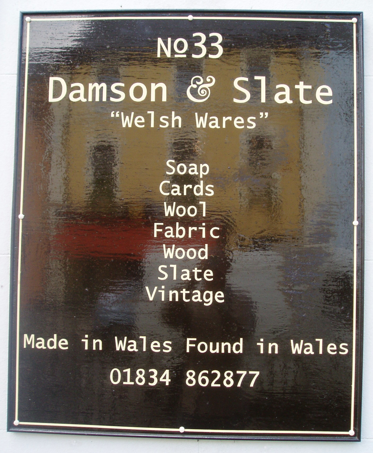

    and this!

    looks good mate, i’m not keen on the font but i guess that’s their choice! it works nicely on the main sign but looks a little odd to me on the wall sign (just my opinion!).
    good first effort anyways,
    Hugh
    2 June 2009 at 20:46
    it does look quite good, but you need more space around your words on the top sign, the font choice makes the L look like a one . on the board you need more line spacing, no one else would notice apart from a sign maker 😀 which is why you are here 🙄
    2 June 2009 at 20:49
    quote Lynn:
    i was thinking that too, if you mean the list of soaps etc?
    2 June 2009 at 21:07
    yes

    Excellent work Patrick, have to agree with Hugh and Lynn about the font, and the layout on the smaller sign.
    I guess these are painted and I think they look great for your first paying job, don’t stop now, get your brushes out again and on with the next job and you’ll it gets easier and you’ll get faster.

    NEGATIVE Space Google it and get to understand it. What it is and the reasons for it. The sign on the wall with the line going almost full with is what I’m talking about should be around 70 to 80% of the width. Don’t scrunch or compress to make it fit either. Choose a font that fits or put it on two lines.
    You will get to understand now you know about it.
    Goop
  • Nigel Hindley
    2 June 2009 at 22:42
    The signs do look like vinyl but I too will bet they are painted with you Lynn
    Great first effort too Patrick but agree with the negative space comments and also slate looks like it is kerned more than damson so looks slightly inconsistent but as above unlikely anyone other than a sign maker would notice

    I think they are painted , you can tell from the 33, slight variations, very well done, 😀

    Some of those ‘e’ letters on the smaller board look way too different from each other to have been produced from ‘plotter cut’ vinyl, although I’m still not convinced it is painted….

    Your Kerning is wrong too. You have too much space around your ‘l’ and ‘i’ letters.
    Looks like a poor rendition of the cut font in vinyl, or a paint mask cut and painted.
    The letters seem like they have lots of nodes Lynn, which is making it look painted.

    Sorry Harry, Had another look and I’m definitely wrong – there are deviations on the lettering so hats off the the artist – well done – wish I could do the same – i’m not that gifted.

    Thank you for your very kind words, it is hand painted. The font is the customers choice, and I will try and Google and understand Negatove space. One of the things I did find hard was managing doing a good job, considering kerninf, spacing etc and procucing an end product within a tiime constraint. I guess people just get quicker and quicker! 😀
  • PatrickBoothman
    3 June 2009 at 06:46
    Lucida Sans Typewriter, is the font.
  • Neil Davey
    3 June 2009 at 07:05
    As you get more experience with brush lettering Patrick your eye becomes more attune to spacing. As you are probably aware, the trick is to obtain a sense of equal space between each letter. If you stand back & squint at the lettering as you go this will become more obvious.
    Also, how do you lay your lettering out? I usually just rough it in with a Stabilo and letter straight off the brush
    And Lynn, you owe me 50p 😀

  • PatrickBoothman
    4 June 2009 at 19:55
    As i was in a bit of a rush for this i did the following.
    1) Roughed it out on Corel. Adding lines to aid aligning when prined onto a4.
    2) Printed it out onto a4 tracing paper.
    3) Stuck all the pieces togerther aligning guidelines.
    4) Carefully drew the boundaries of each letter with a 6B pencil on the rear.
    5) Placed the joined sheets onto the board with the rear (6B) touching the board and taped it in place to avoid movement.
    6) Went over the boundary of each letter again with a HB pencil thus tracing the boundary of each letter.
    7) Painted the letters in.
    8) Cleaned off any pencil marks.
    Would love to have the confidence just to use a stabilo to mark out a basic form, one day, maybe!!
  • Steve Maple
    7 September 2010 at 14:36
    you need to thin the paint out
    paint the panels flat
    you need to kick the habit of using fixings through the surface
    -i.e. on the larger panel affixed the panel , countersink, then fit the trim and nailed it with lost heads, touched in the nails.
    the other method, on the door panel, would have been to use a ‘hockey stick’ moulding – spell checker is wrong
    -inch and a half, if the panel is 1/2 inch, screw a batten to the wall, and nail it up sideways.
    -this also is the method you should use on the longer sign, also i bodes well if your next go wants a panel length of more than 8 feet and you have a central joint.
    battening across the joint-fill sand, fit hockey stick all the way around
    -it does actually help you in the long run, as when you come to install it you are fixing a 2 by 1 to the wall, then simply hanging the sign on that – it helps if you are on your own.
    plus the job will last longer, as there will be no water ingression into the joint.
    plus on the long one, you could have had the longer runs curved, the trim would have bent at least a few inches, then the central ampersand ‘could’ have been as big as it is….
