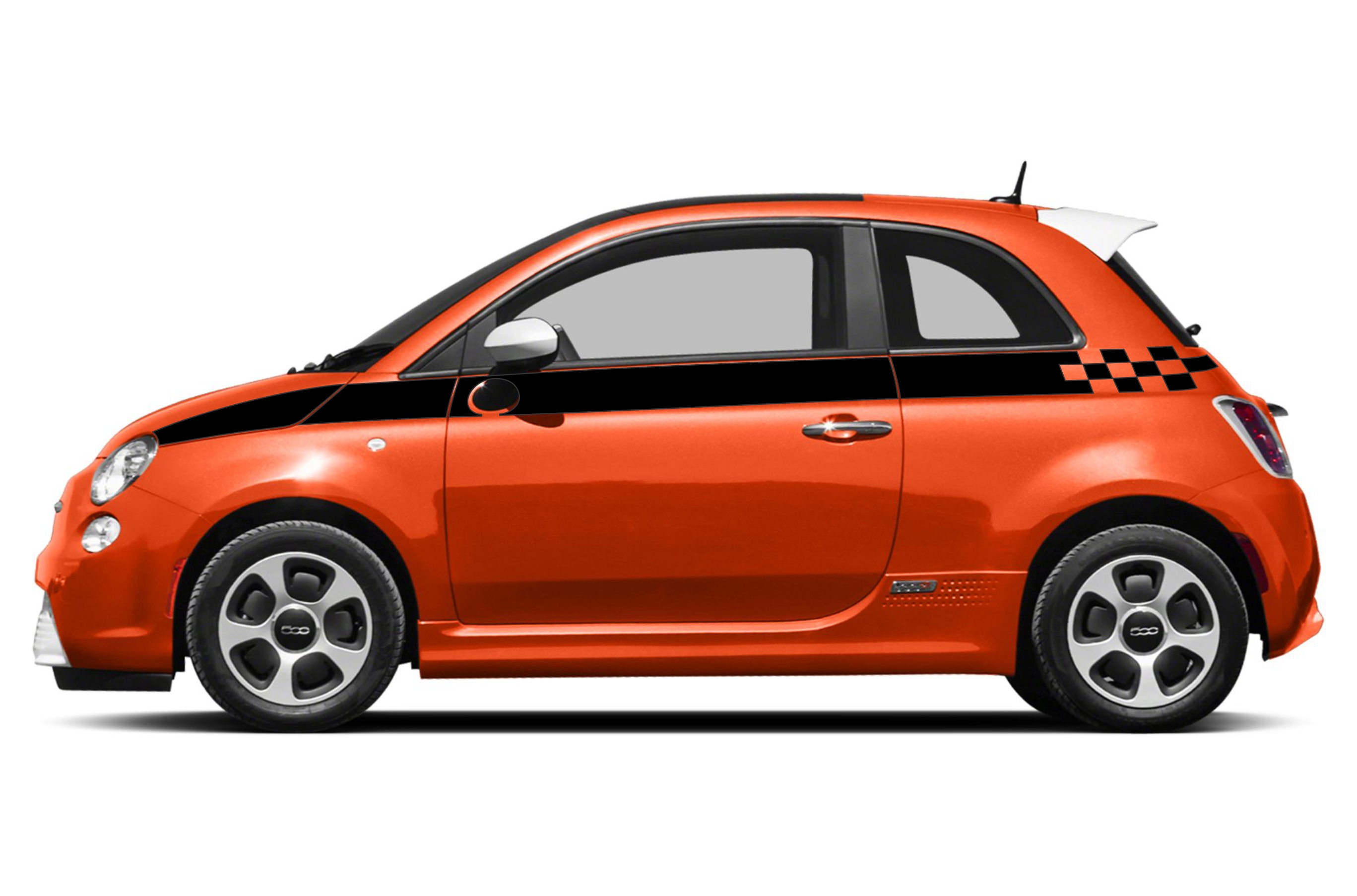

    Hi Guys
    I have drawn this stripe on the best res car I can find but it’s just not right when I fit to the car (Curves). Going to take alot of try’s to get it right. Anyone out there sell me the template, Please? I know I could use knife tape but it’s for my local fiat independent garage so there will be a few in future
    I have one waiting to do 🙁
    Gaz

    My opinion would be to just cut a black stripe to the right height, not curved. Where it turns into flag at the back that part of the stripe will also be cut. Regarding the front, looks like its just cut into the bonnet line. Only tricky part i can see is the ovals cut out. Need to measure these up and pre cut from the beginning of the stripe you cut.
    Thats how i would do it anyhow and im pretty sure if you did buy the kit they wouldnt be curved, you just need to follow the curce of the vehicle
