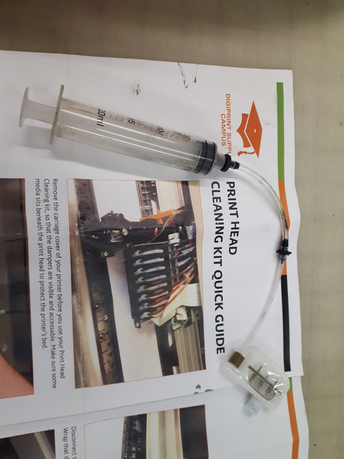

    You could get this head cleaner kit from Digiprint Supplies works a treat and simple to use.

    The head cleaning kit from Digiprint I’d avoid personally. The internals of a DX head are really delicate and you can easily damage it beyond repair if too much pressure is applied (product of experience as we’ve used one of these before !) Roland don’t recommend that one is used either.
    They can and do work but they are a bit of a gamble.

    Dan, do NOT get one of those flushing kits for your machine. Your VS has a DX7 head, not a DX4 as pictured. You won’t get that damper inside your printhead. Best thing for you to do on your printer is a choke clean (CL clean I think it’s called from memory). If that doesn’t fix it you’ll probably need a damper replacing next. Let me know if you want me to come and do that as I think you have a maintenance contract with us don’t you?
