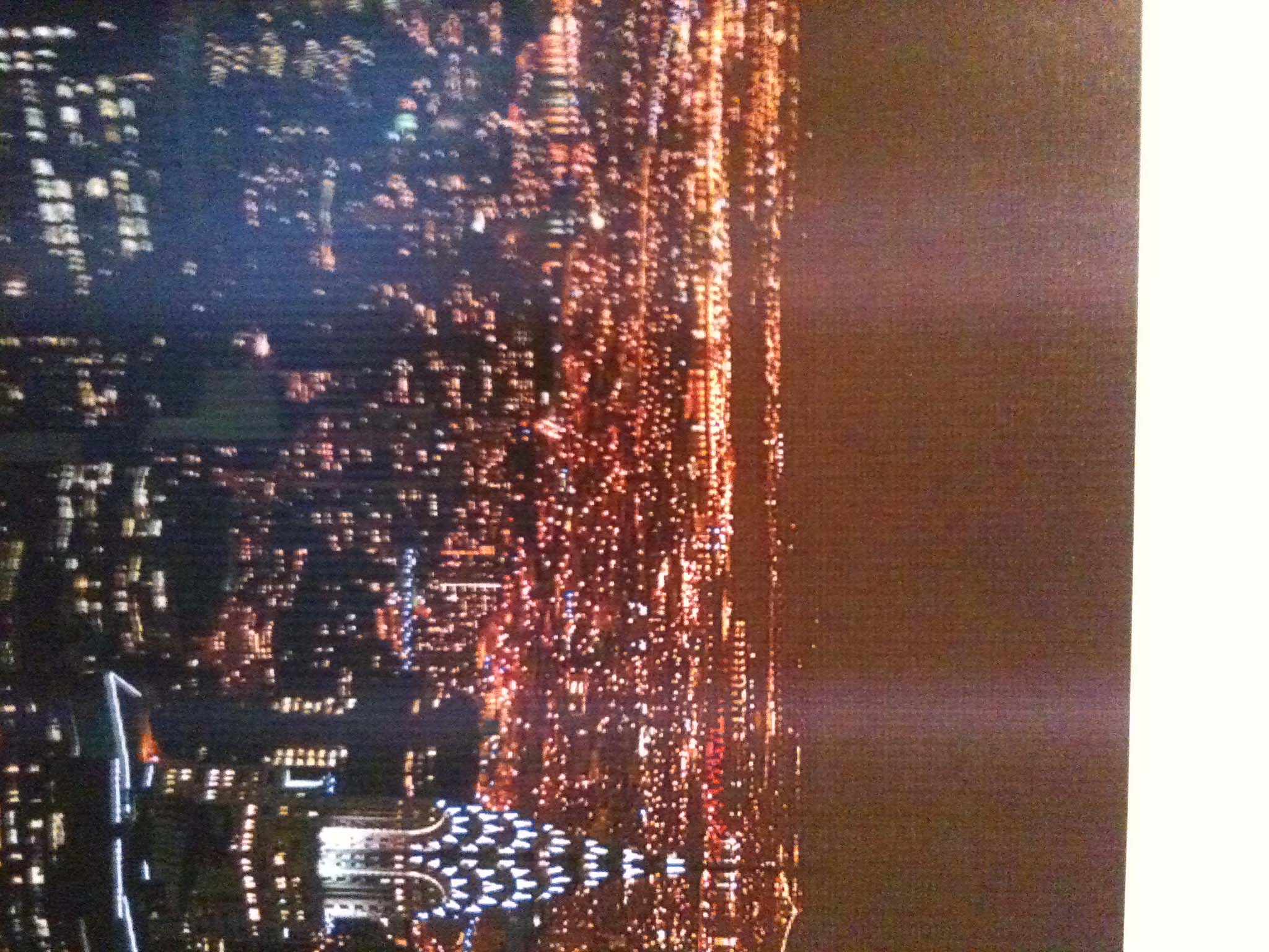

    I have this annoying problem my sp540 when printing lets say dark night view for example will have faded areas where it shows the blue ink randomly around the print. I have new damper new heads new carriage board new head cables and i have sucked plenty of ink through the lines. No nozzles are missing but keeps happening.,. Oh encoder strip is spotless#??

    looks like a static problem are the two faded areas = in distance to 1 dia of the roll.

    say you put a new roll of banner in and unroll about 5ft, start printing and as the 5ft is used you unroll a bit more whilst its printing i see a mark as shown. let the machine pull the roll it don’t do it.(but i don’t like doing that)
    also seen a row of text with like a slight halo around it look at it with a magnifying glass and you see the ink is scattered.
    change materials and all ok again.
