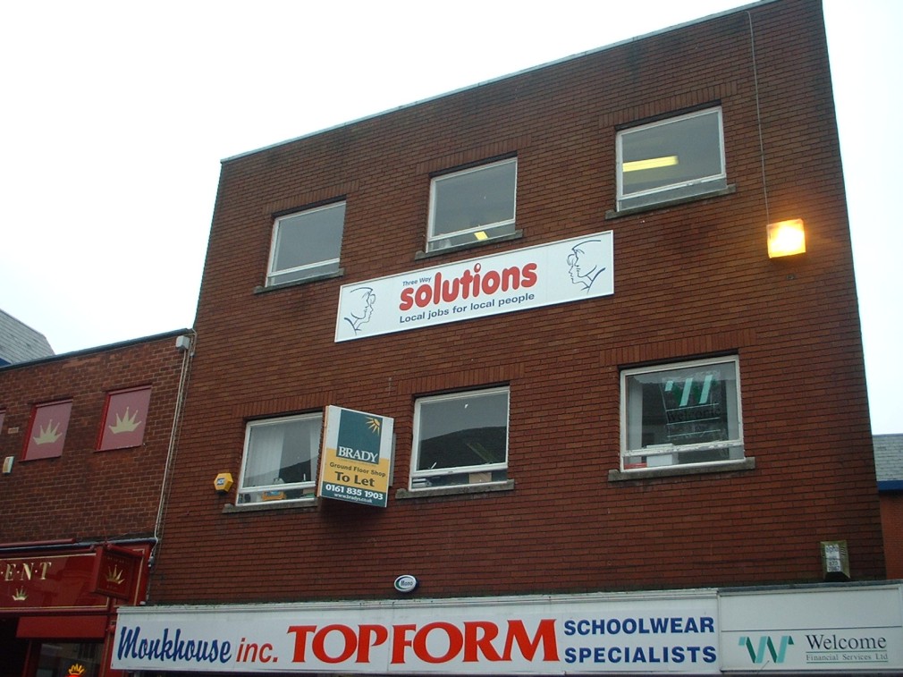

    Hi all, just finished this today, nothing special, except its the highest one we’ve done; using a cherry picker

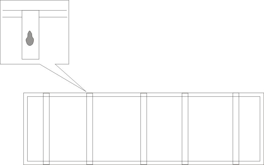

    whilst we were assembling the frames back at the workshop, using the demo that rob did we stumbled across an idea to assist a single person to mount the frame onto the wall and fix in place.
    I have done a quick drawing to try and explain it.
    basically we drilled a couple of oval holes in the frame uprights, drilled and plugged the holes in the wall, loosely screwed a screw into each hole, lifted the frame up and mounted it onto the screws; TEMPORARILY HELD IN PLACE, now my hands are free to drill and screw the rest of the mounting holes

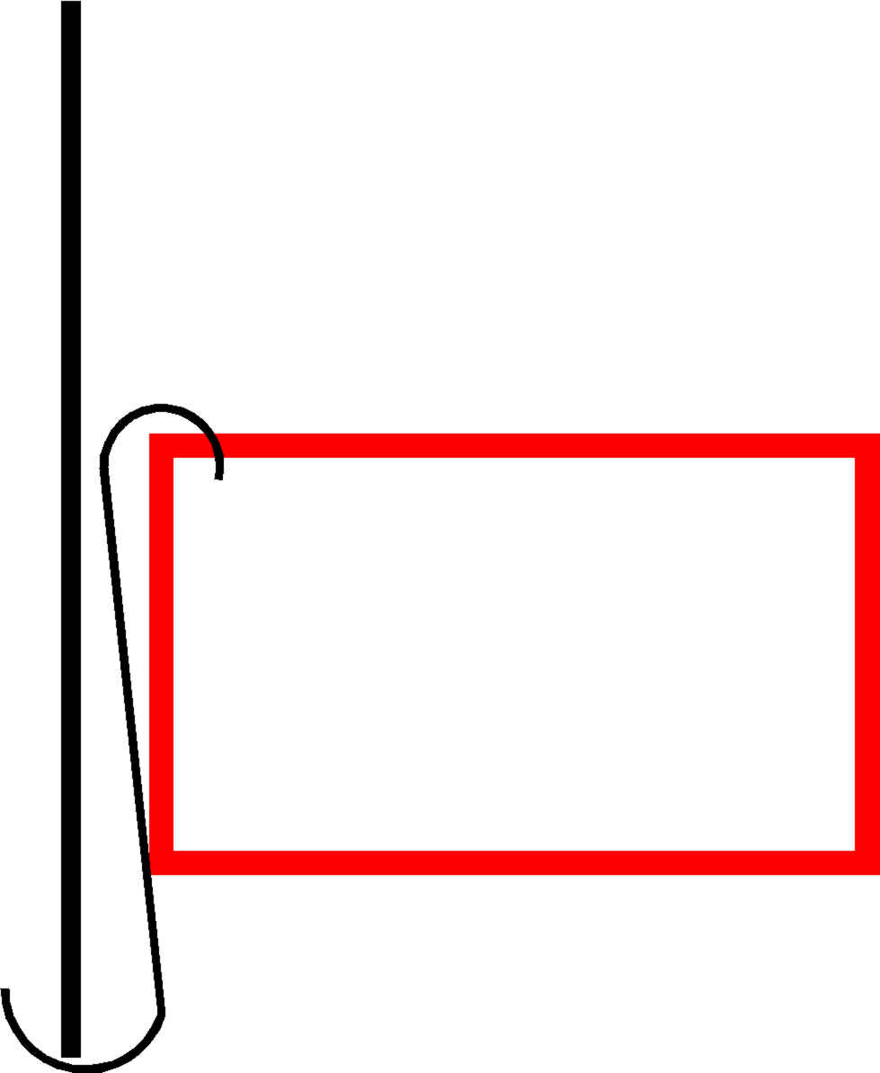

    Another tip to get the sign up there when working one man in the basket , is to cover 2 pieces of 12mm bar with hose pipe or similar, bend into an s shape then hang the sign from the bottom and onto the cherry picker cage.

    17 February 2005 at 21:09
    like this

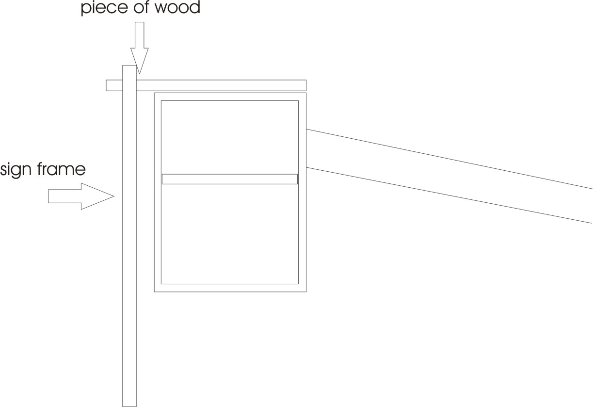

    17 February 2005 at 21:19
    this is how i did it
    a couple of pieces of wood on outer edges of basket, bunjee strapped, then the frame is simply rested on the wood, the basket is lifted up into position, right next to the wall and the frame is slid into place

    17 February 2005 at 21:24
    simple but effective, but the hooks also work for solid signs in ali foam or whatever and after you lift the frame they work for the panel
