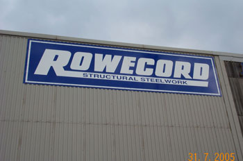

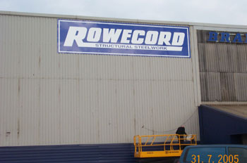

    Hi, this is my first sign using dibond, it’s in two panels measuring 8m x 2m and blue vinyl on a white background. I couldn’t get over how light it was considering each sheet was 4m x 2m. Fixed using techbolts.
    Think I’ll use more of this in the future.
    Only problem was feeling sea sick after coming down off the scissor lift 😀
    Cheers Neil

    Nice looking sign. I’m trying to get my customers into Dibond. Nice to work with.
    Regards
    Lee

    Just to clarify things, you have to fix though to the structural supports on
    these cladded buildings dont you. Rather than just to the cladding itself?
  • Adrian Hewson
    21 April 2005 at 11:37
    We only fix onto the cladding itself, these screws grip the cladding and pull the cladding and the sign together
    Regards Adrian
