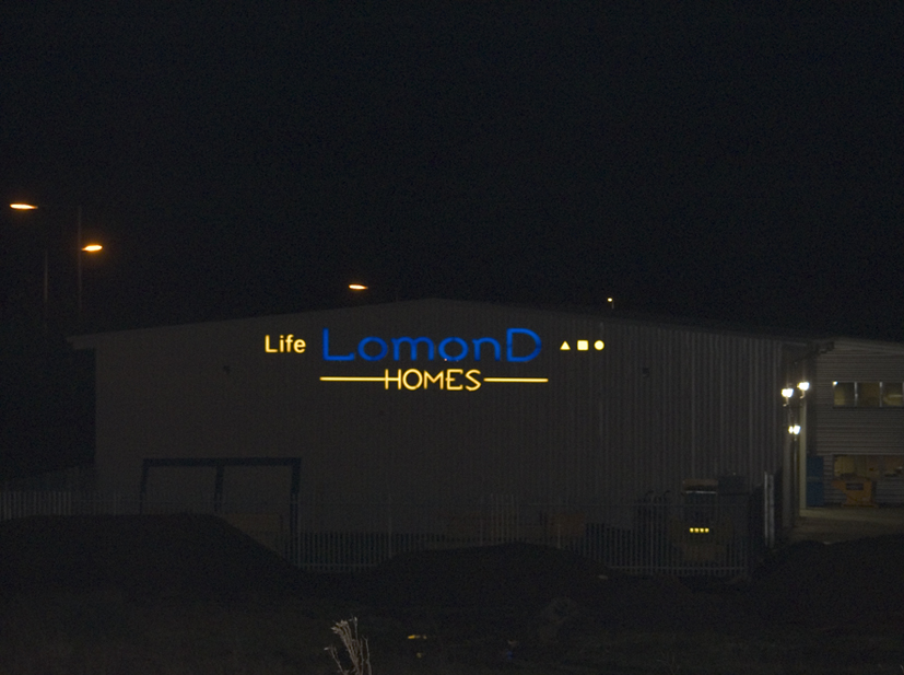

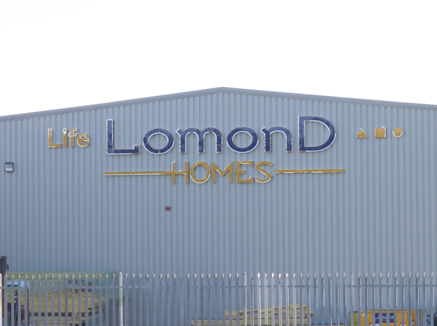

    Manufactured in stainless steel rim and return front faced with coloured acrylic illuminated with neon, Individual letters of Lomond were over 4 ft high. (builidng was double skin watch this if you ever do neon), got the scissor lift stuck in the mud, tried to drag it out with a awd forkilft, nearly sunk this and then had to get a JCB to get all of us out. Customer videod it and said the video alone was worth the money.
    Another happy customer but boy was I glad when this was finished (we had to do a smaller version on the back of the builidng as well (that is where we lost he forklift truck

    Very nice!! Do you fabricate the letters in house Adrian …. if you dont mind me asking? Would be great to see a night shot aswell to see the illumination.

    Nice job… Looks good on the night pic.
