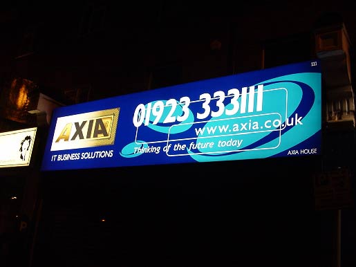

    This is one of the flexiface’s I was talking about we did. This company is also a supplier for our computers.

    Certainly looks the part – nice sign
    What are the bennefits of flexiface signs compared to normal acrylic – is it just a size thing?
  • Steve Lamb
    25 February 2005 at 15:09
    Glen
    Benefits of flexface over perspex/acrylic are
    No Joins
    No Gaps
    No expansion or retraction which can cause bowing
    If someone decided to throw a stone at it, it would bounce back and hit them in the nose 🙂
    Its alot lighter than acrylic
    Easier to maintain
    A very good difusion of light across the whole sign.
    Its just better
    down side is, its more expensive to produce/buy than perspex 😕

    sign looks great steve… very smart 😉
    the one i am doing is particularly boring… 😕
    what size was this steve?
    thank you for taking the time to post it…
  • Steve Lamb
    25 February 2005 at 21:38
    err, 16ft x 4ft i think from memory.

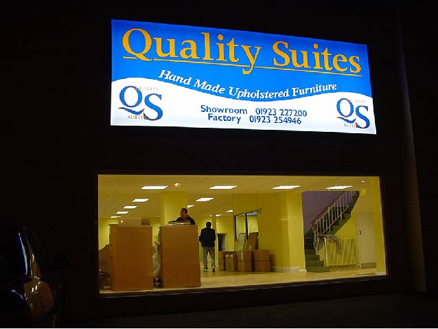

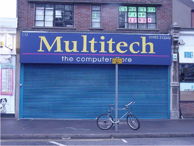

    Here’s another couple. Did the multitech one back in 98. Still drive past it at times and still looks good
    The other did back in 01 did change the bottom phone numbers after this pic 😕
    Don’t take many pictures any more must remeber to do so.
