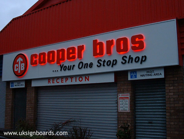

    another sign i did in the past that i have found tonight…. sorry if i posted before…
    this one is done in metal builtup letters powder coated and fitted to alu-colour with flat cut prespex, raised letters. the rear of the letters has been halo-lit using ashby LED’s, framework panatrim.
    the built-ups were fabricated by vinnie at pheonix signs. we designed, routered the flat cuts, installed the leds and fitted.
