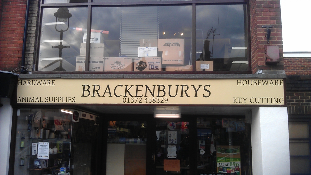

Do yourself a favour leave a breathing space (negative space) around the edge, board like that i would be looking at 50mm
Kev
Thank you for your advice. It was my first design project as I normally just install. The problem I had was the bottom left hand corner "ANIMAL SUPPLIES" was to close the the main name part when I bought it in from the edge. The customer wanted it all in upper case as well.
Also it was applied direct to the old glass shop front. We were going to change it but it would have caused more issues trying to remove the old frame and glass. The previous owner had not changed the front for 20 yrs.
Well done Ian, nice job mate.
like kevin says tho, a little more space around the edge of the sign and text and a bit more gap between the shop name and telephone number.
