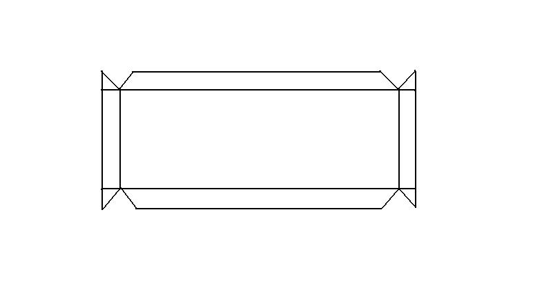

    I’m hoping to fabricate my first tray and was wondering what is the best way to go round doing it. I have attached a layout plan is it right? its a complete guess off my head.
    Also i’m thinking of adding 3mm acrylic sheeting behind the tray using vhb tape my only concern is would it warp and then come off??
    my last question is would you just screw or tape the box on corners.
    Thank you for your help
    Sorry forgot to add attachment! please find attached.

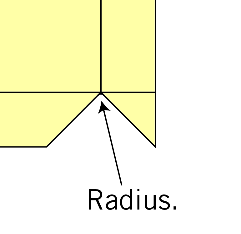

    You need a corresponding angular cut on the long edges to complete the corners.
    Make a test pattern out of card first.

    I’ve never made my own but have had both styles of corners, one similar to how you have done it and then cut straight cut edges that meet up so the join runs done the corner (if that makes sense) I find the join down the corner actually looks a bit better as long as you get it nice and neat and would presume it’s much easier to do.

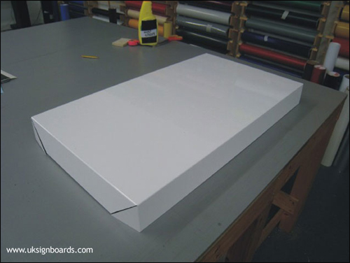

    5 January 2013 at 17:28
    As Peter says – you need a slanted cut on the long return otherwise you will have a section of material overlapping which will look unsightly. This is the method that Dibond themselves recommend as it means the corner itself is finished, with the joint itself being away from the actual corner (and therefor not visible when looked at from below or the side). But I know many people get good results using Warrens suggestion. I have used both methods and both will work

    I do the join on the corner but you do have to be very neat with your cuts and even a little bit of tension in the diabond can cause it to come apart slightly.
    I might give the method that Phill has shown a go next time though.

    7 January 2013 at 20:10
    No
    The shape you want to cut out is as shown here

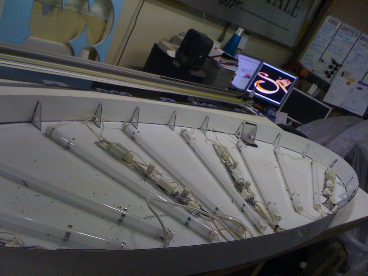

    I have used both UHB gel tapes and Polyurethane adhesives in the past just be very very careful with surface cleaning before bonding.
    A 160mm return will be fine for getting a good light spread from the tubes but I share your concerns about supporting a return of that size.As long as it is fully supported you should be ok, lengths of 150mm angle ?Or an internal tray as you say…

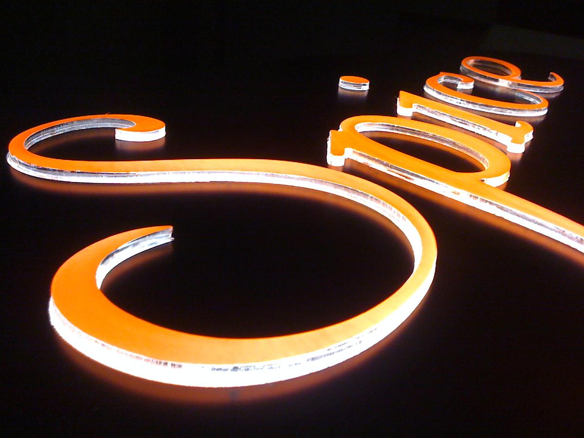

    see images below for one I made a few years ago..the back tray is fabricated completely from ACM. The return was bonded on rather than folded as the light tray was oval. The letters were 10mm clear acrylic flame polished with a lightbox vinyl to face, mounted onto 3mm opal.
    To be honest I would only use this method for internal signs these days. Unless you have your own CNC i doubt it would be cost effective.
    If this job were to come up again I think I’d farm it out to a trade supplier and have it fabricated in Ali then powder coated etc etc.

    8 January 2013 at 18:37
    Machined the letters, cleaned up and polished the edges then applied translucent orange vinyl.. I just cut out pieces of vinyl by hand big enough to cover each letter, applied and knifed around the edge.

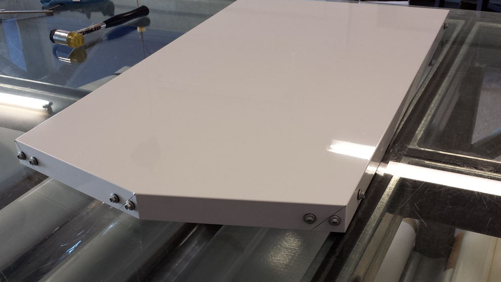

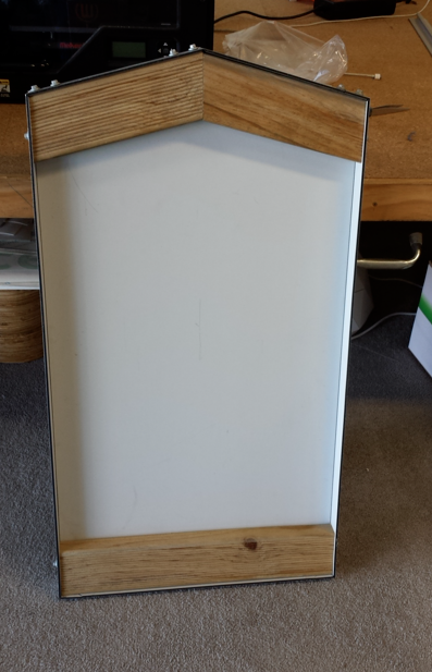

  • Simon Worrall
    30 May 2014 at 21:10
    I found I didnt have a 3mm bit so I used a 4mm – it worked perfectly well, and the slight bulge in the corner doesnt really seem that bad.
    I enclose a pic of my first tray.
    THey wanted a roofline at the top – lord knows how I figured out the angles but it all fitted together very well.
    I used treated wood behind, and roofing screws to put it together so they could mount it from the back. Yes I know the screws are ugly but they are so common here they are part of the culture.
    I have made a few trays since this one to practice different ways to fit them and assemble them, and to make up a few samples. They have not really caught on in NZ yet, but when they do I will be ready!
