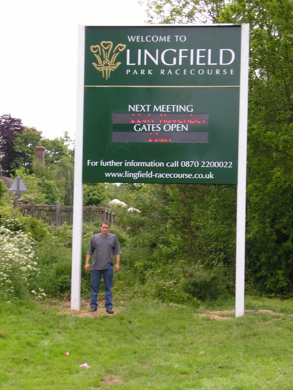

    The biggest sign i erected at Lingfield.
    I didnt realise how big it was untill I saw this picture

    😮 Is it braced from behind, or in deep concrete?

    The posts have base plates welded on and have a lot of concrete
    2 metres deep

    Nearly straight or is the camera at an angle 😉

    cameraman was still drunk

    great job mate, whats the sign made from dibond?
    did you have it put in place all in one via hi-ab or…?

    The sign is made from ali trays on an ali frame bolted on 4 inch steel poles.
    The sign is double sided with LEDs inside which are changed by a computer which you plug into the bottom.
    The frame was bolted on then lifted in place with a hi-ab, then scaffold up and on with the face.
    Nice when it was finished
