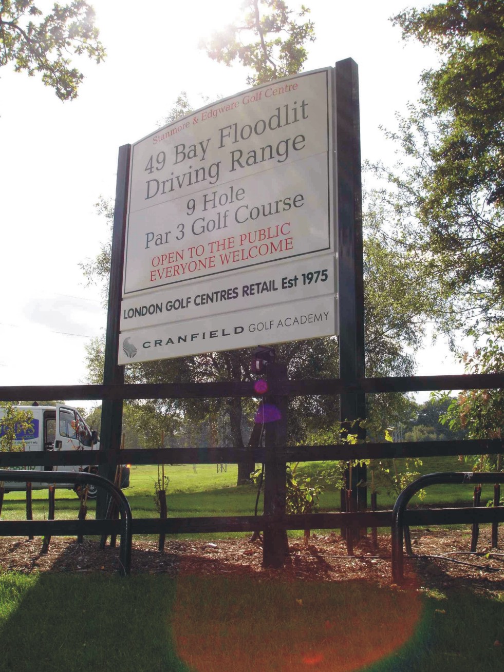

    Thought I would show this golf course entrance sign.
    There were two of them, I had them made by my local steel fabricators,
    the trays are folded ally, and the posts were 5mtr x 160mm box mild steel and all powder coated.
    The posts were so heavy it took four of us to lift and position in the holes
    the signs were made where the panels bolted onto welded sections on the insides of the posts, so there was no margin for error when fitting, they had to be smack on.

    woo thats a biggy martin…..looks great 😀

    Nice job martin! …. oh and the sign’s big too! 😉

    😉 It’s so sturdy too!
