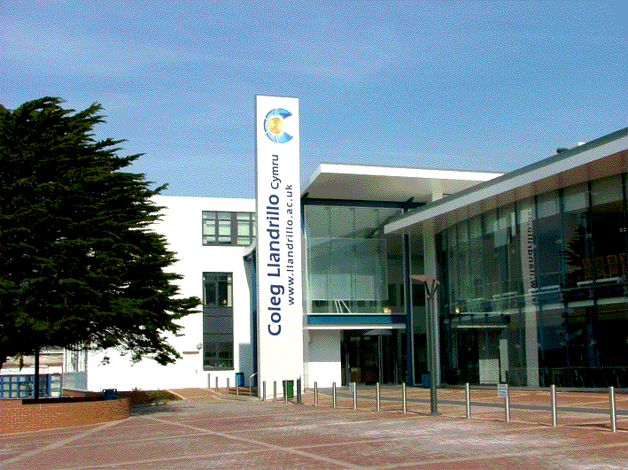

    Posted by coolinshot on 14 June 2004 at 13:19
    Just thought I’d post a job we completed a few weeks back. The letters are individually cut dibond. The logo at the top is printed from a “jetsolver”, mounted onto white dibond and jigsawed out. Fitted with the aid of a cherry picker.

    Looks pretty cool – What material is the monolith and how did you fix the letters?

    Looks really good. nice and clean design!! It’s certainly a sign and a half!
    Would be interested in knowing how the fitting went, how many guys/girls it took.

    Hi Stephen / Carrie
    Myself and one other fitter working from a cherry picker – the whole job took less than 5 hours to fit. That includes struggling with paper templates on a pretty windy day but other wise it was quite trouble free. The logo was awkward as it got windier the higher up you went and the panel itself isn’t small. I like the end result anyway – it’s going into my portfolio along with the “beware of the dog” signs I usually make.
    Thanks for all your comments.

    great work as always mate.. cant have been easy, but you did very well. :thumbsup:
    looks pretty high.. what hight is it approx?
    is the jetsolver a spandex solvent printer or is that jetster? 🙄

    Thanks Rob:
    It’s about 15 metres total height – not too scary but it was quite windy so the cherry picker was dancing around a lot and the templates had to be stuck down very quickly.
    The Jetsolver is basically a converted Roland Hi-Fi jet – bought from AIT. We’ve been using it for over 3 years now and after a shaky start, getting used to all the maintenance it seemed to require, it’s been a fantastic purchase. The print quality is very good at 720 dpi and the colours are vivid. The only drawback is the print speed which is about 2 running metres per hour @ 720. The inks are Solvent based using refillable cartridges.
