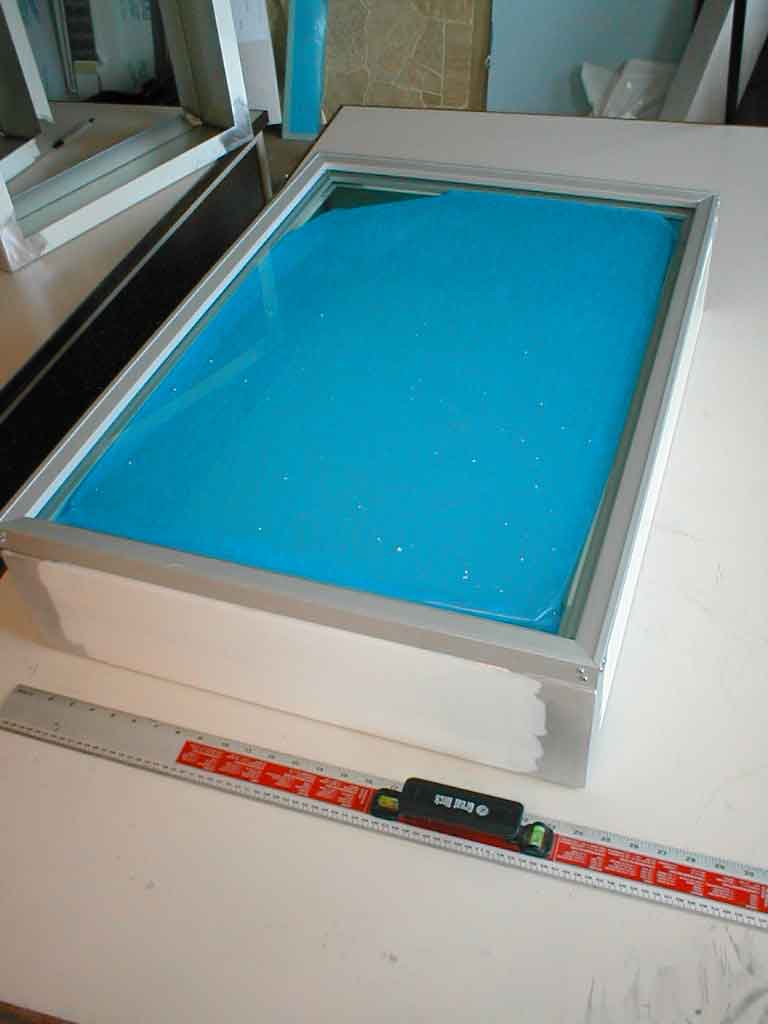

    Hi all,
    Someone recently asked about poster lightboxes. As luck would have it I’m just finishing off 3 lightboxes for a club in bristol.
    They’re made from aluminium sheet which was folded and welded by a local metal fabricator. The opening face is panatrim reinforced with corner brackets, and fitted with 5mm clear perspex. Behind that there’s opal perspex held in place with aluminium angle and stainless steel screws. The sides were covered in oracal751 silver metallic vinyl.
    I hope the pics are reasonably self explanatory.
    cheers
    Joe

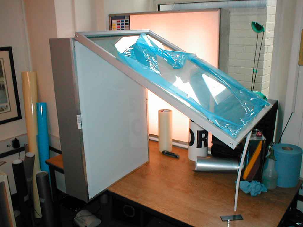

  • Joe McNamara
    5 March 2003 at 18:13
    and here it is lit up for testing. It’s quite bright in the workshop so it dosen’t look as bright as it really is.
