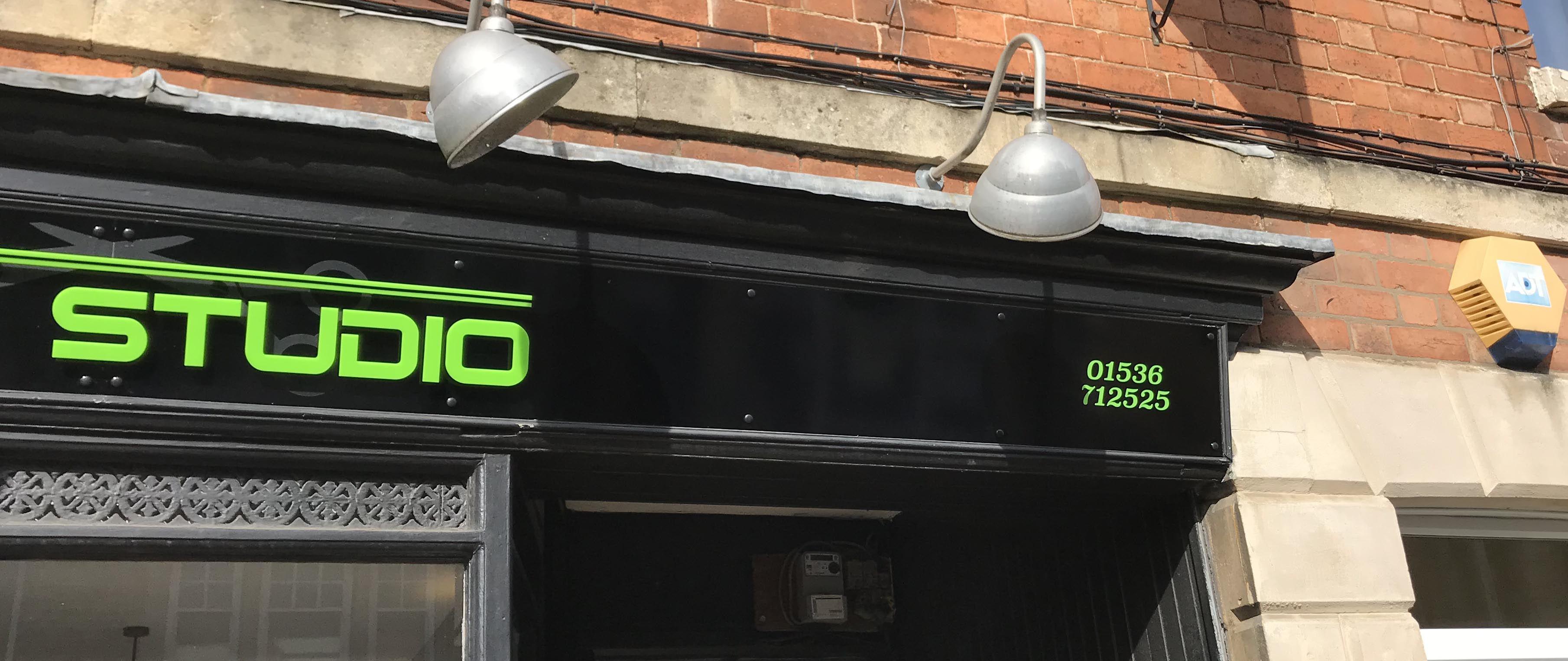

    i wouldn’t recommend putting any sort of S/A vinyl over a wooden facia, especially an old one.
    Can you not flood coat an ACM panel and screw that to the facia first before applying the letters ?
    See Attached of a job we did a week or so ago, same problem
